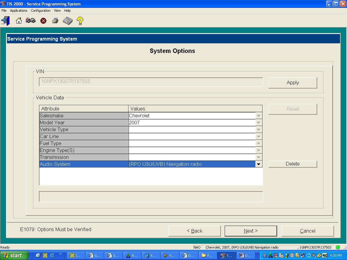

My original configuration was the 2007 navigation head unit (I installed; came with the deluxe Bose non-navigation radio), RSE (from the factory), and reverse camera (I installed using the video input on the back of the head-unit and NO reverse camera module under the passenger seat which is basically a voltage converter). I also have the Bose system with the Bose amp and subwoofer. This has been the configuration I've been running for the past 3 years with no problems whatsoever.
This past week I just changed out my 2007 navigation head unit for a 2009 that is NavTraffic capable. (I also have the NavTraffic XM module thanks to mirage00.) XM is up and running, NavTraffic and the navigation itself are all good. What I am missing now are the chimes (I don't even have the prompt anymore in the DIC to control the chime volume level.) My RSE also doesn't show up; no video. How does the changing of the head unit dictate this when the settings are in the VCIM and BCM or is it the culmination of both including the head-unit?
I took it to the dealership to get programmed and the tech told me that when he puts my VIN in the system it just spits out all of the original settings, and that he can't make any changes. Has something changed in the past few years with the programing software in Windows before going to the Tech II? (See attached pictures for example.) I thought you could go in and pretty much "line by line" choose what you have. RSE, Bose with amp, check, reverse camera, check.
What am I missing, but more importantly how can I insure that I get the right programming done on the head unit this coming week? The tech said he had to call GM and ask them questions.

Goto this website and put in your VIN. See if you can specify your radio part# and amp configuration. This is the TIS2WEB application I used, not TIS2000 windows app as your images indicate.
