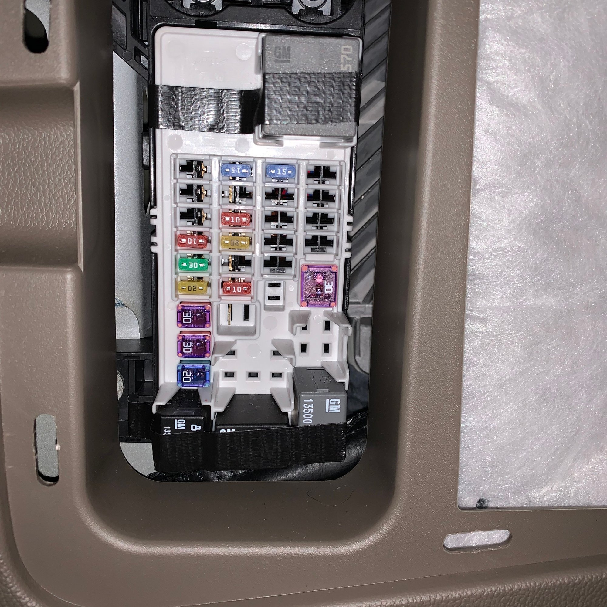

Hello,
I recently found my SUV lift gate does not respond to any command whether from remote or the open trunk button. It's dead silent when the button pressed.
I found the fuse box on driver side in the cargo, and missing a few fuses, where labeled lift gate. Only #16 presented.
I don't know whether they were there before or not, so I'm asking if anyone has the same year 2017 and model LT, taking a picture of all the fuses layout and I will compare with mine.
Greatly appreciate your help.
Thanks,
P.A.

I don’t have fuses in 2,5,6,16, & 18 it looks like, and all my heated seats and lift gate work. This is a 2017 Burb Premier. I know not exactly the same but tryin to help.

Thank you SDfromSD.
I was able to eliminate the fuses issue from your image. I also ordered the relay for location #16, just in case.
