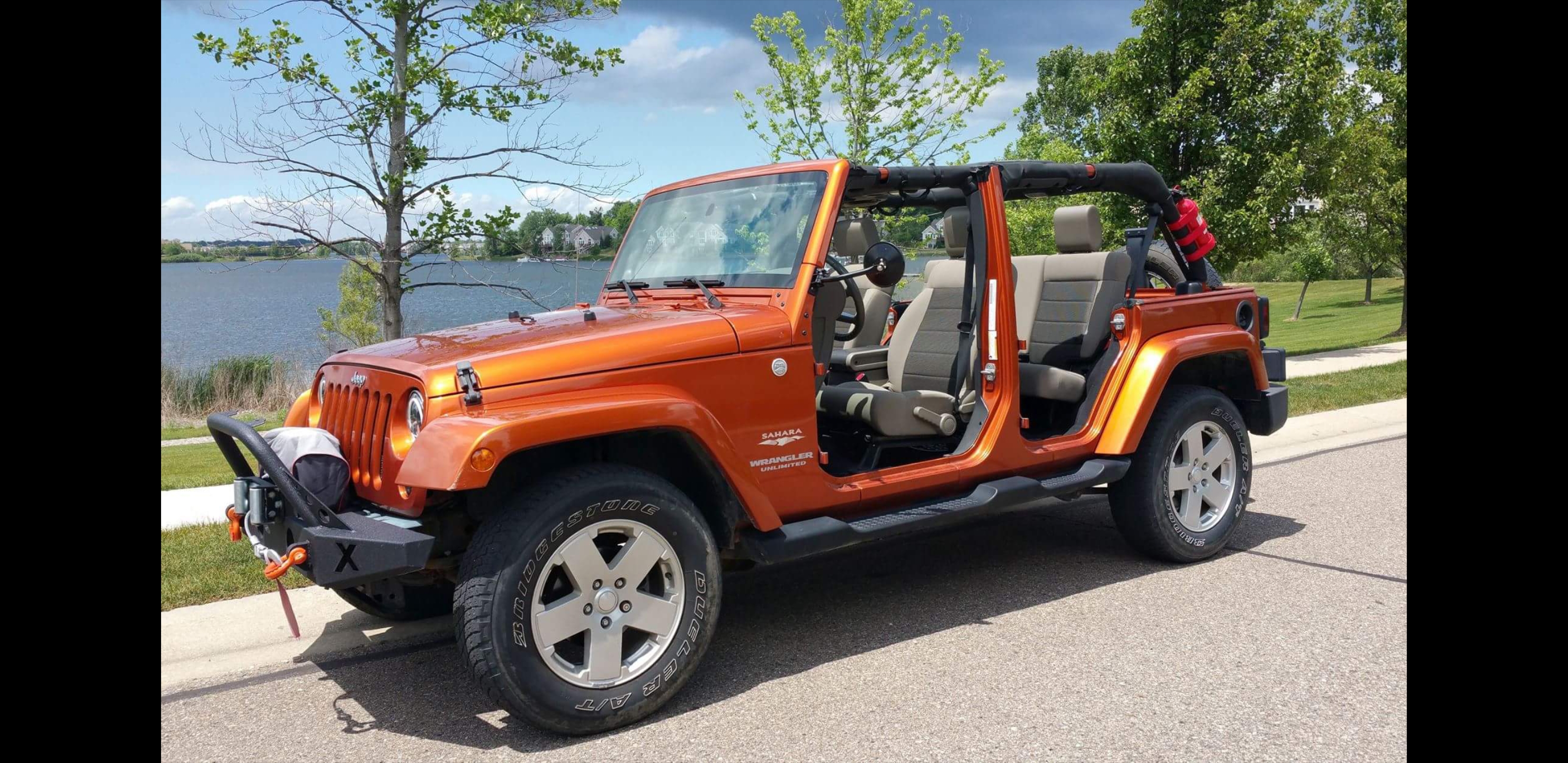

IMHO, you're opening a complete can of worms.
Sell the Suburban, buy a Jeep, and mod the snot out of it.
