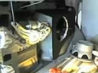

Yes I didn't mention the obvious hard stuff like the liftgate motor. Here is a gratuitious photo (crappy cell phone pic blow up) that shows the liftgate motor on the rear driver side and a custom sub box I had built andshoehorned back there to be completely hidden...
