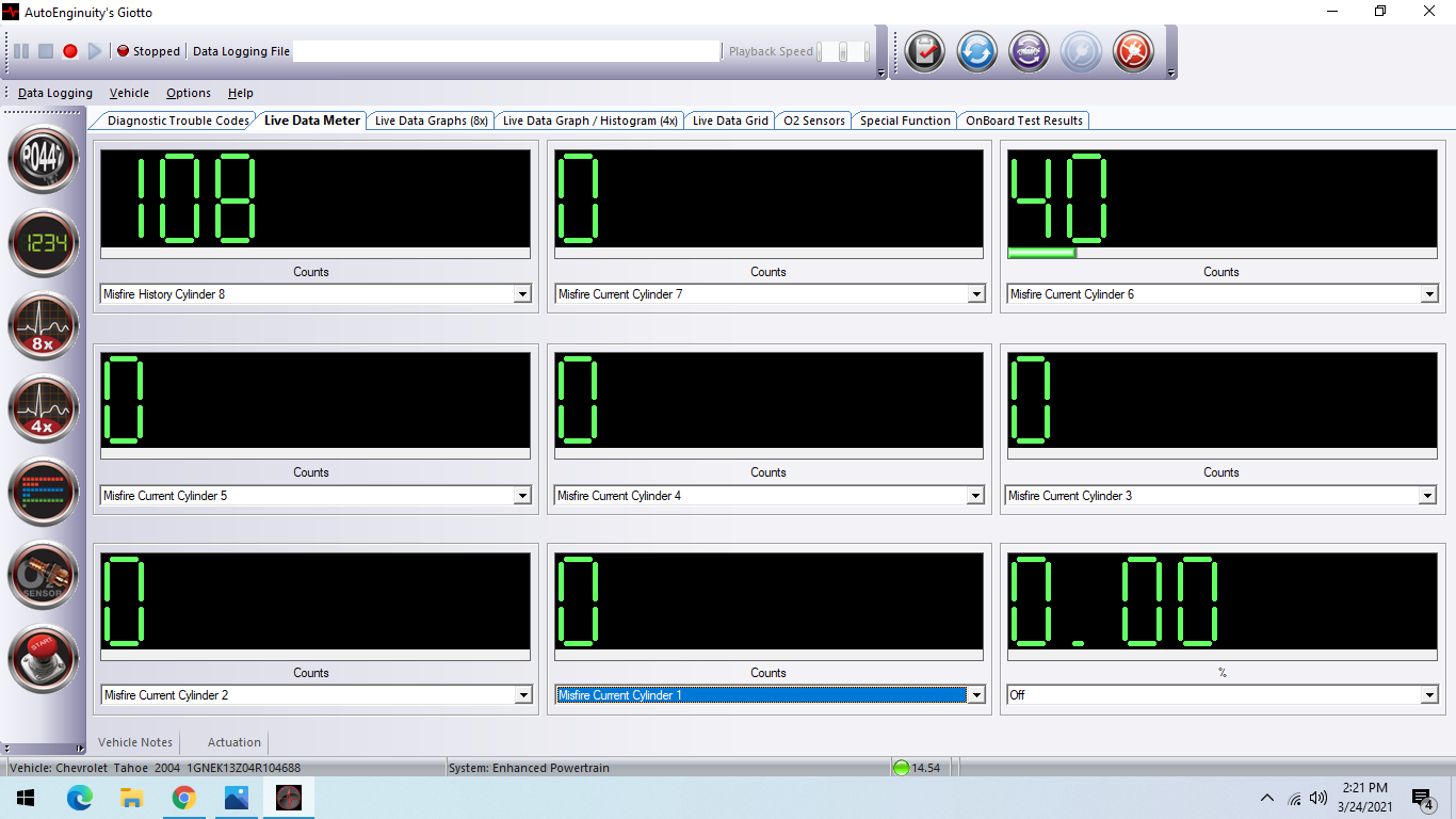

Using Auto Enginuity software we pulled Code P0300. The only current code.
We found cylinder 6 and 8 bank 2 had misfires ( We are now showing misfires in cylinder 7 bank 1 as well).

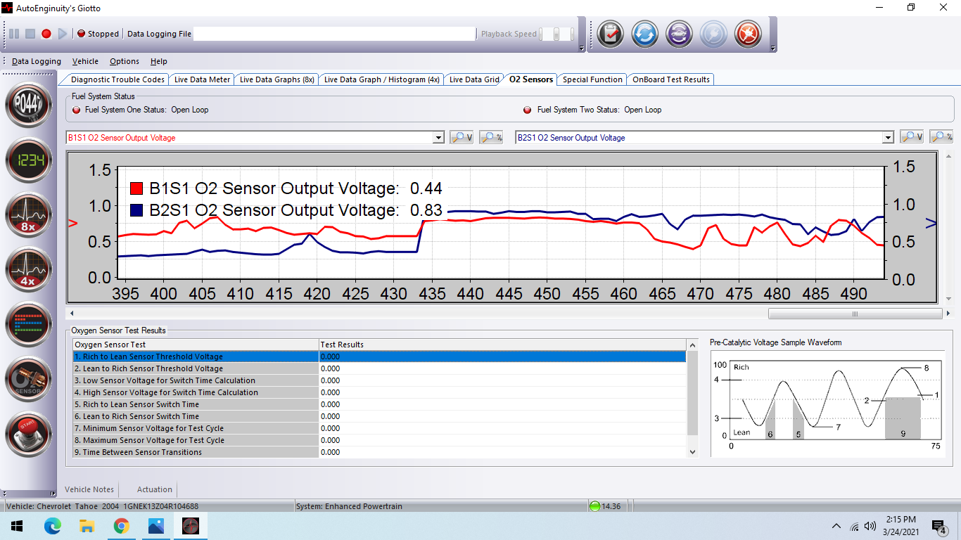

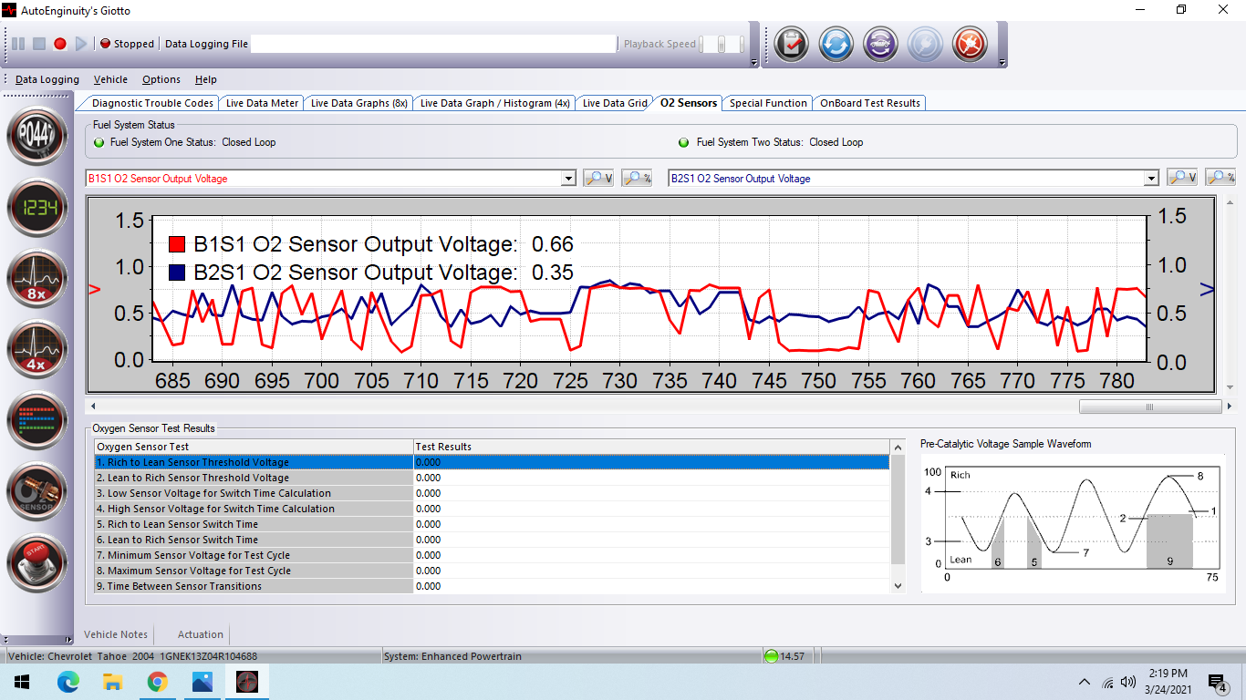

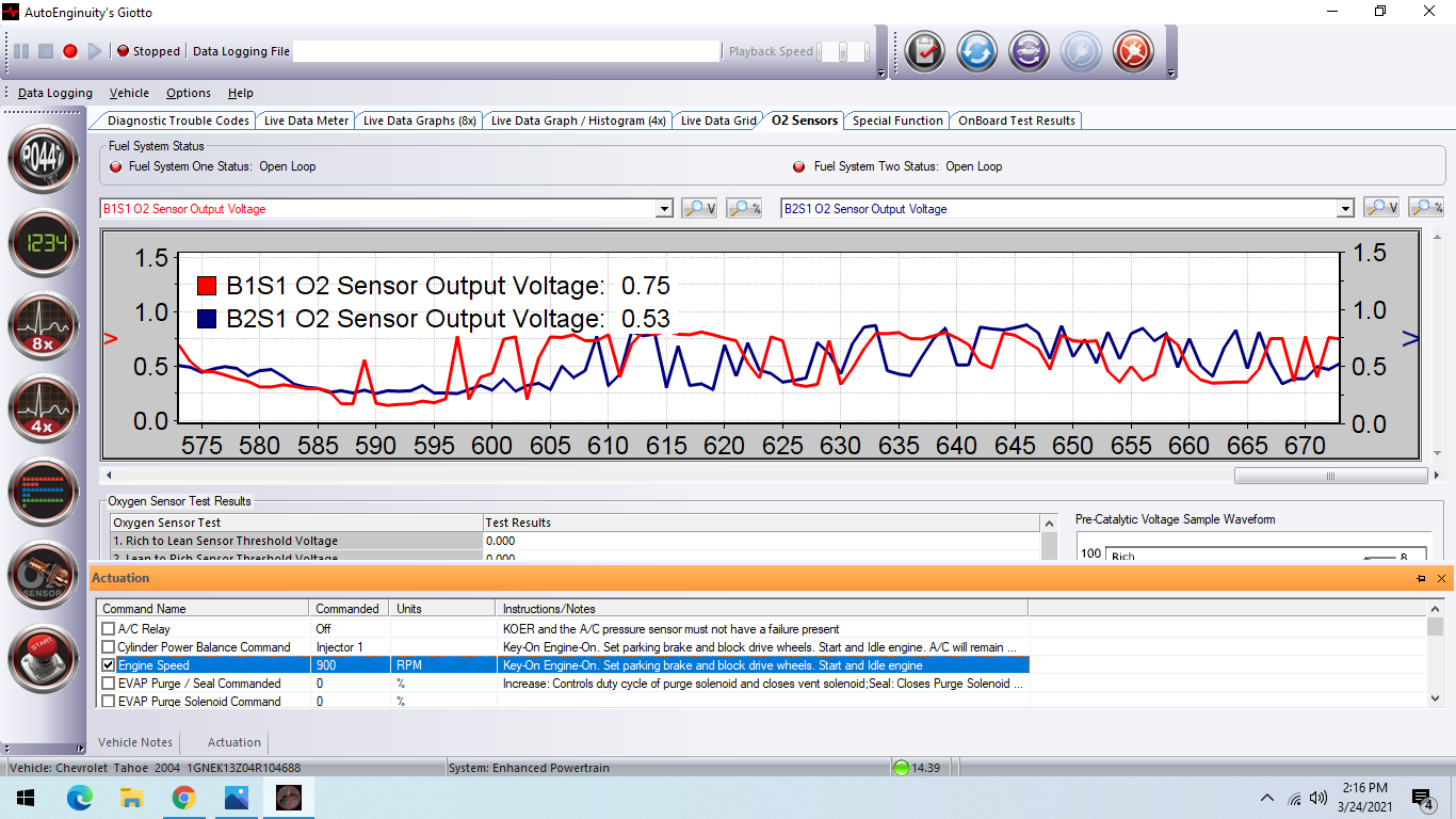

O2 output voltage:
B1S1= 0.34-0.81
B2S1= 0.37-0.70

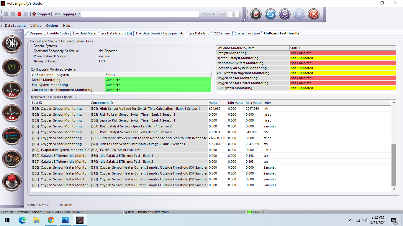

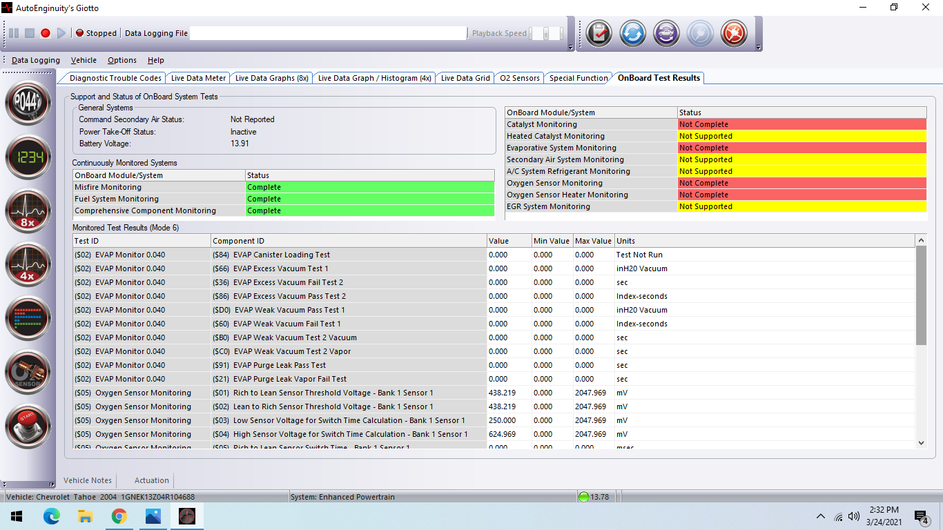

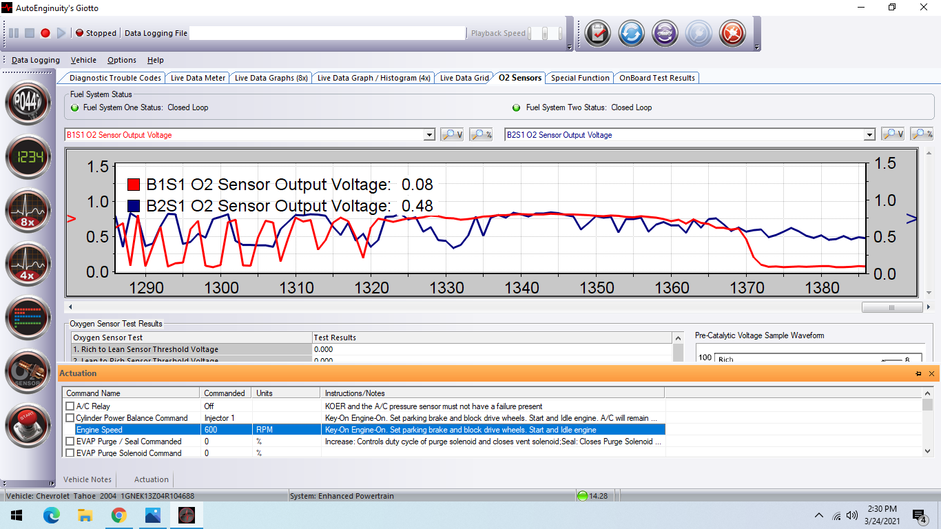

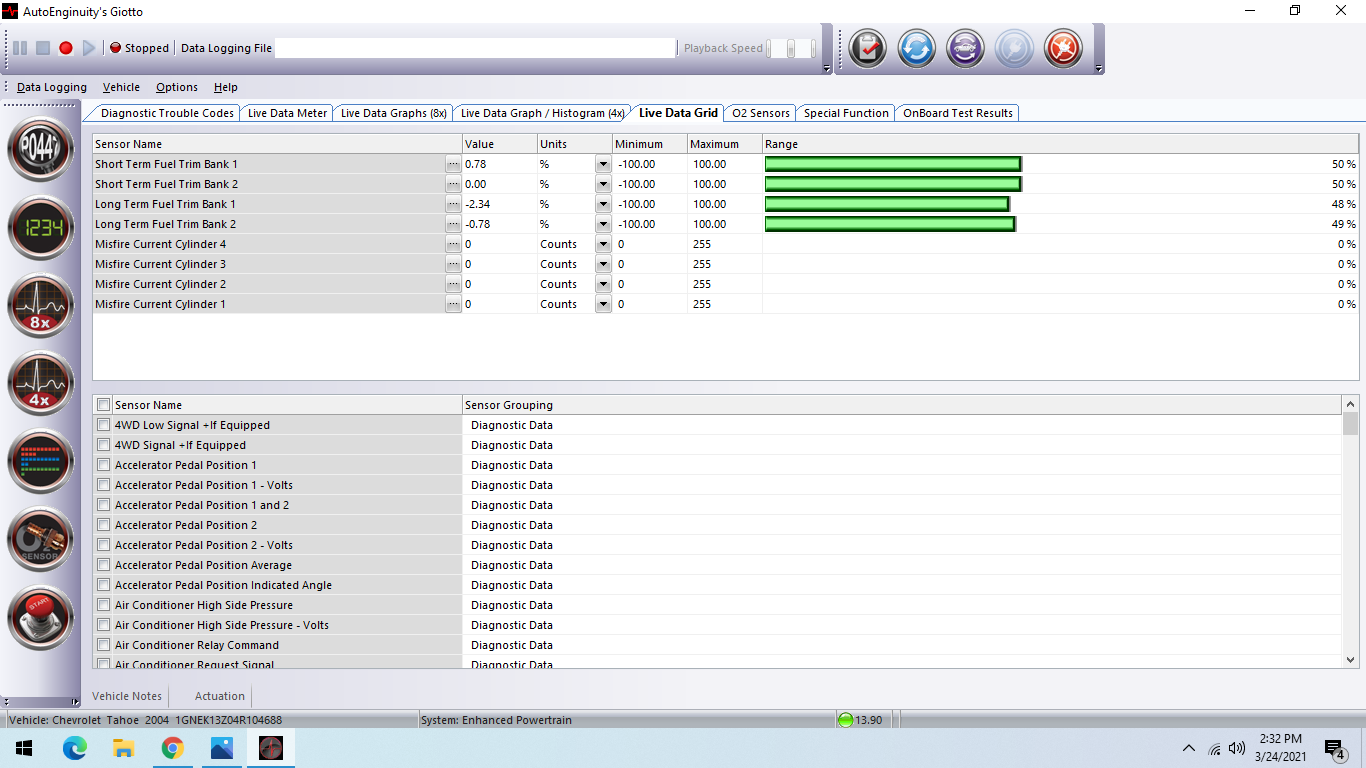

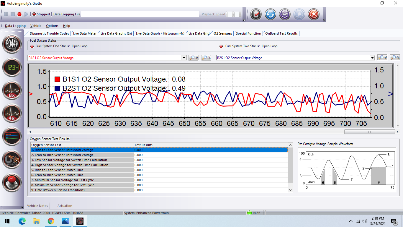

I will post some screenshots of the test as they are moving around a small bit.
Cold just started
Cold just started
Cold just started
Cold just started
Cold just started
Cold just started
Cold just started
Cold just started
Cold just started
Cold just started
After warmed up
After warmed up
After warmed up
After warmed up
After warmed up
