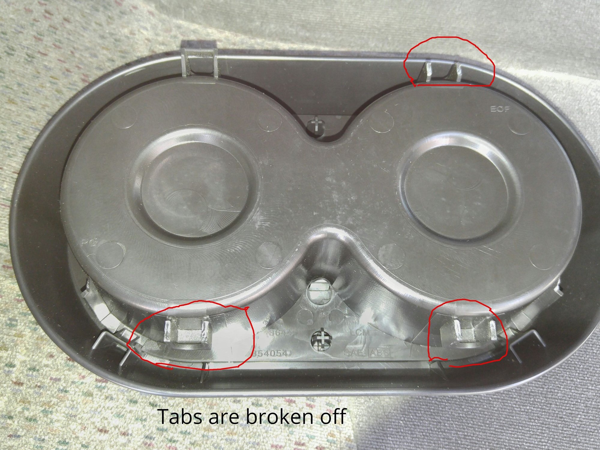

I picked up an unbroken cup holder for my rear seat but can't figure out how to remove without breaking the tabs.
I've tried pushing in the sides but no joy. I don't want to crack/break the replacement.
Any recommendations? The armrest color is darker than mine otherwise I would just switch out the entire armrest.

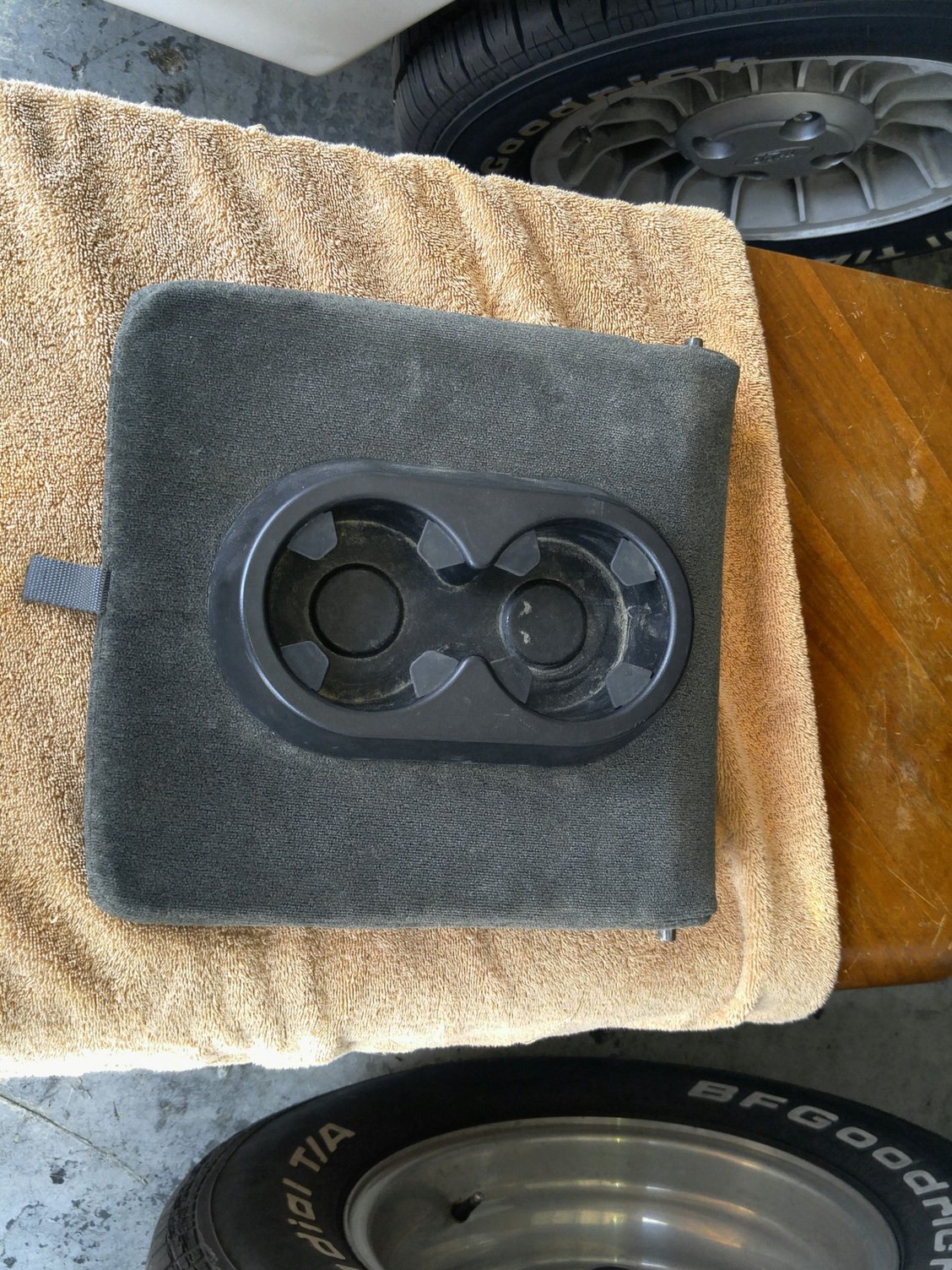

Well, after some examination I came to the realization there is no way to remove the cup holder without cutting the armrest up.
You can access the rear by opening the rear upholstery flap but the interior foam fully encases the cup holder.

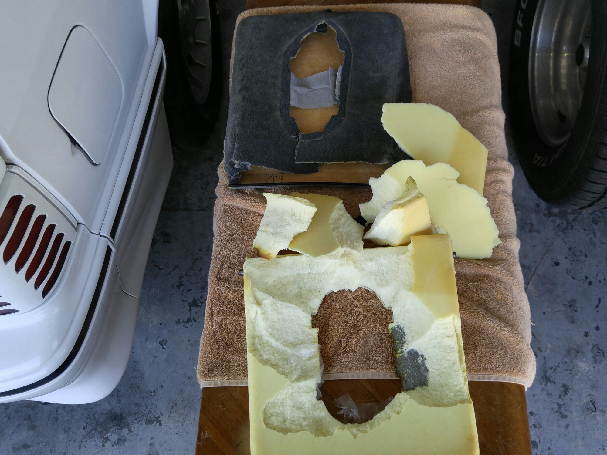

Cut away the outer cover and tear away the foam to reveal the tabs and the metal sheet inside.
A flathead screwdriver makes quick work of getting the holder out.
Holder just snaps into the hole and all is well now.
The aftermath.....
