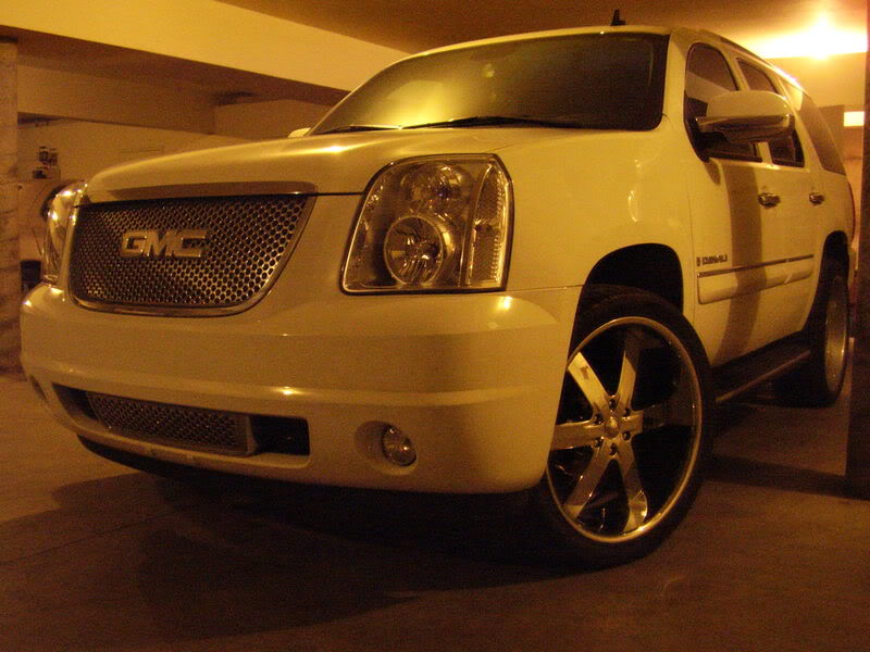

That's wrong, I took mine apart on my white one and took out the amber corner. They came apart pretty easy. I've modded my lights on all of the 8 cars I've owned. It just takes some time, and practice. The Yukon ones were by far the hardest, just because getting the front lights off I had to take off the whole bumper. Here, check out these pics from my white one before it was wrecked. Notice the corner has no amber.

The instructions are the same as in the link above that the guy did to his scion. From the point after you bake and get the lense off is up to you. It says pretty much everything in detail there on how to get them apart. I did a couple of black housings before on my R32 and my old STI. I used High Temp flat black BBQ grill paint. They don't have that in white, but I know they have hight temp white spray paint at schucks, kragen or whatever it's call in your area. It's made for painting parts on the insides of the engine bay, I used it once on an older chevy. Make sure you don't paint the reflective dome the light trasfers off. I've had HIDs in all my cars too, and never had a problem with anything melting. On my old R32 the lenses were starting to turn a greenish yellow, you could only see at night cause of the heat. I finally went to projectors in that. To seal them I used black waterproof, high temp sealant. I have the tube still, I don't remember if it was silicone or what the base was. I went to home depot and the dude told me what to use. Don't get clear, you can see it and it looks like crap. It dries like a blue clear. I went over it with black and you can't notice it.

On your white yukon, after you removed the amber reflector did it appear that something was missing there or did it look like thats how that headlight was made? I've been dying to figure out a way to get rid of that amber reflector and this might be my way out of it but I just don't want my headlights to look akward after I go through all this work to remove them. And one more question, after you do all this is there away that moisture can get inside and produce that "dew/fog" you see in some shady aftermarket headlight kits?
