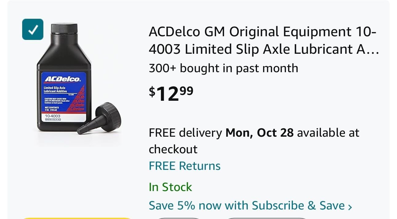

Originally Posted by chamco79
Here is the solution to this common problem i fixed my 2021 suburban with the following 3 products and saved thousands because after dealing with this problem for over a year i was going to buy a new differential but before I pulled the trigger I decided to give this cheap solution a try and it worked 100% i have zero noise or vibrations it drives perfect 👌 I love my car again. Make sure you get 2 bottles of the ACDelco 10-4091 because the differential fluid capacity is almost 2 quarts.
easy DIY project just need a little hand pump to put in the new fluid after draining the old fluid. drain plug is located at the bottom and fill up plug is at the back of the differential.
Dealerships are going to hate me for this tip Thank me later 😆
So just for reference, you put the 2 bottles of 4091 and 1 bottle of each of the other 2 and that did the trick? Not sure why Chevy doesn’t know this. Seems a lot of people are having the same problem and shouldn’t Chevy be looking into this more for a defect. I know they don’t want to due to cost, but this sucks to pay 70k for a truck with bs like this causing issues.
Did you ever figure out if 2 bottles of 4091 and 1 bottle of each of the other 2 is the correct formula?
