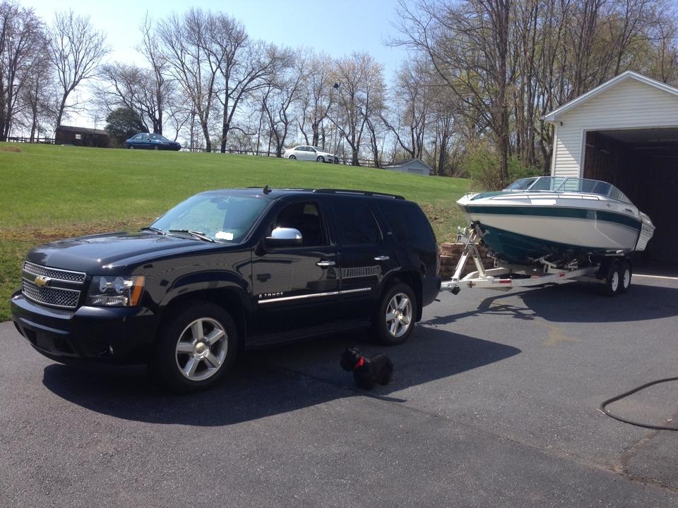

Toys make the Tahoe look small lol
Attached Thumbnails Safety Alert-10264564_10202661588273738_687685905698630743_n.jpg
