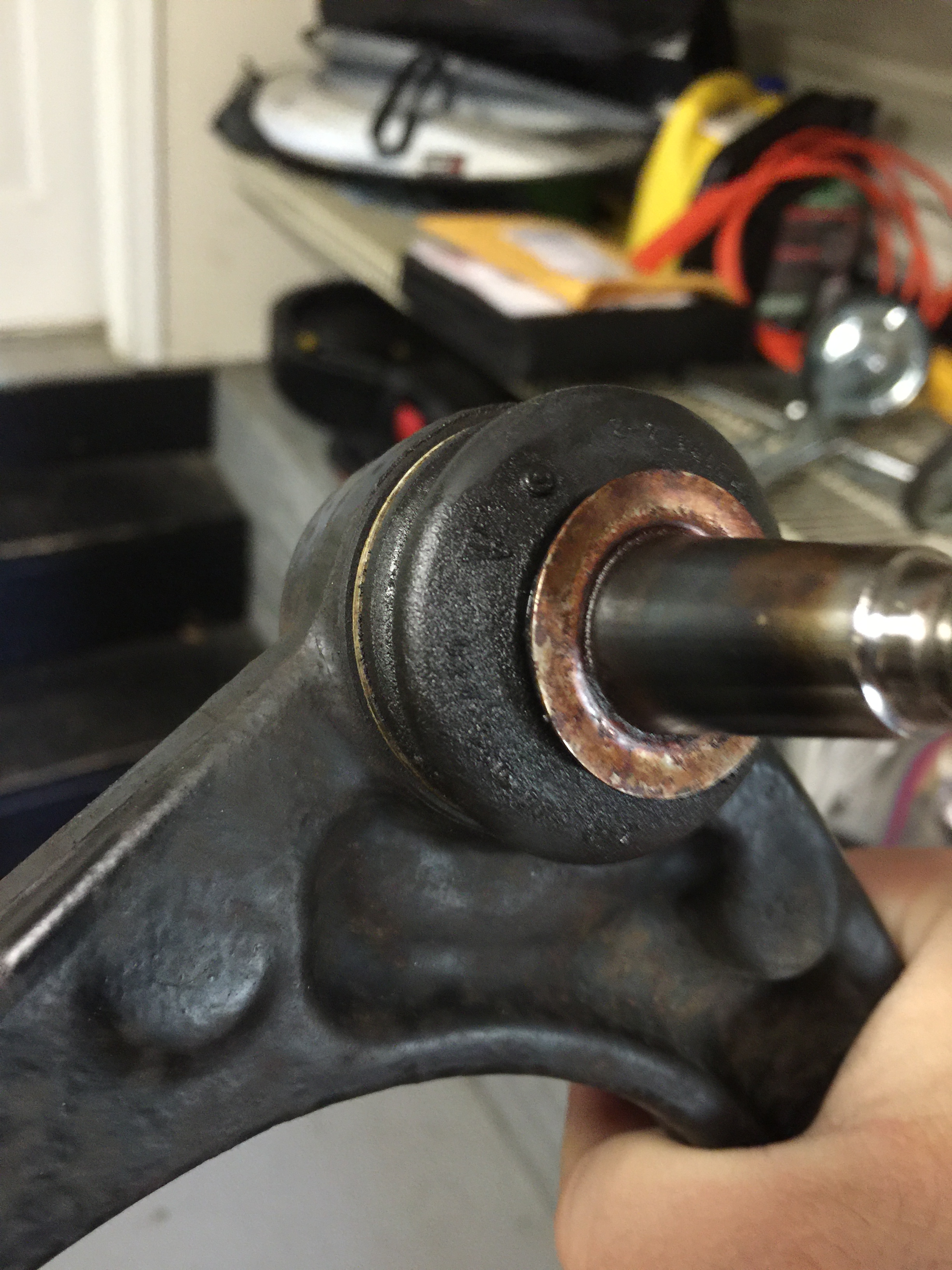

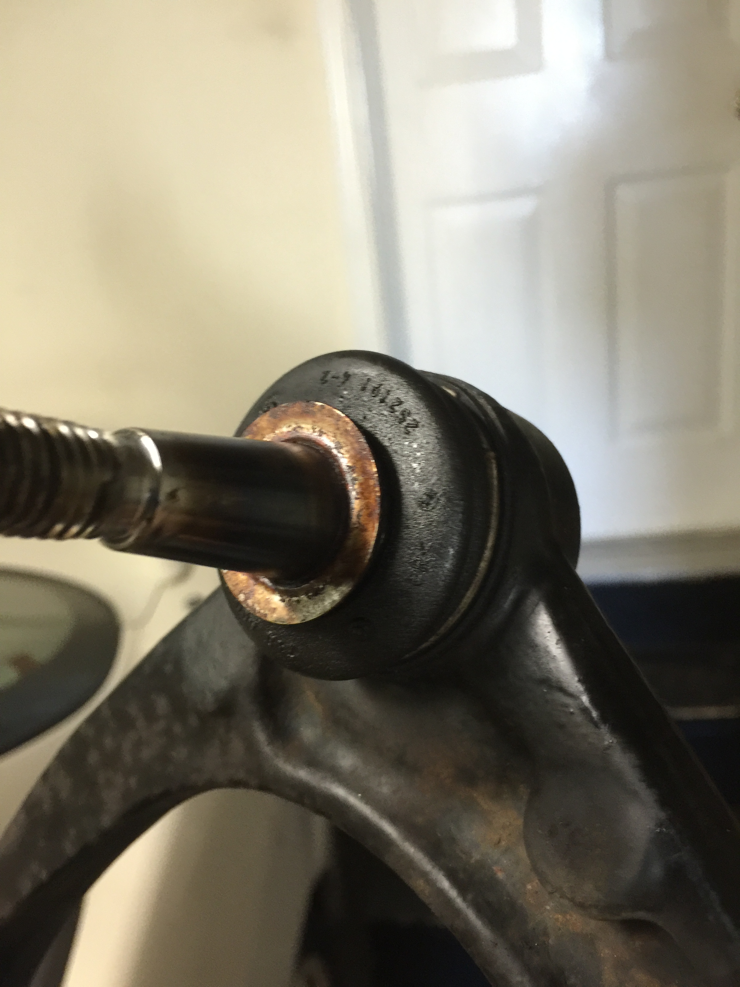

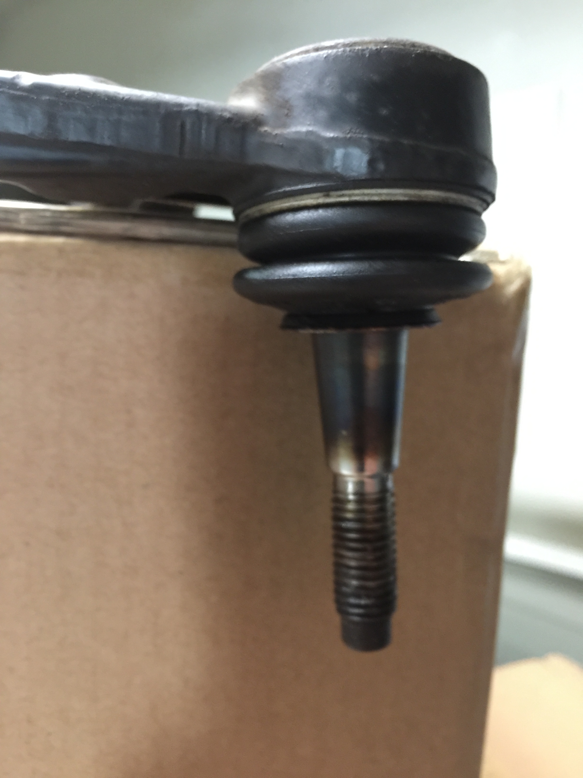

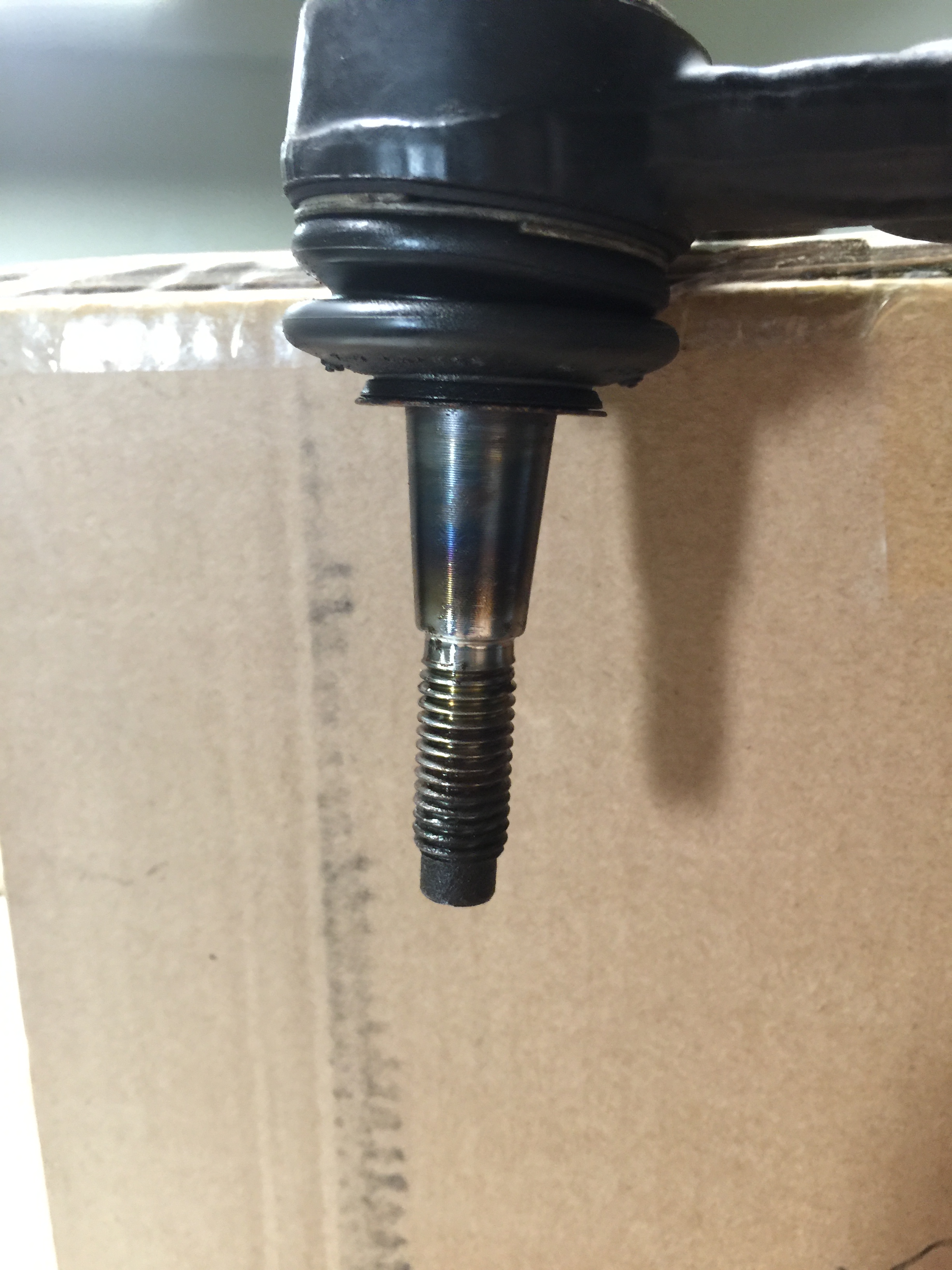

I forgot to ask one of my questions. I have the old part in hand, so how do I tell if a upper ball joint is bad? Just from looking at it, it looks fine. I don't see any tears. When I pull and rotate the screw part it feels ok. But when looking at the pics of the bottom of the ball joint, it looks goopy like the grease has seeped out, even though I was putting pressure on it, and couldn't get anything grease to ooze out. I'm really hoping this thing is bad, and that they didn't bs me.

there is no way to check the upper ball joint once its removed from the steering knuckle. it would have to be falling out to have play when removed.

for this generation the upper ball joint cannot be changed without replacing the control arm. have a look at his pics.
