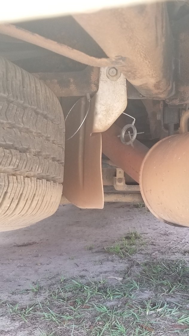

As I look under the rear of the suburban I'm seeing something I never saw before... can anyone identify this?
Rear of vehicle to right side of spare tire.
I regularly look under my 'burb and I've NEVER seen this. I noticed it when it was on the lift getting serviced (when I was being savagely torn a new one via my wallet). Looked today and it's still sitting there resting on my muffler.
It obviously doesnt belong there. I have no idea where it goes though!
Silver-colored bracket looking thing... under rear of Suburban to right side of the spare tire and resting on muffler
It sort of looks like a cup holder that the wheel picked up from the road and it got captured there.
