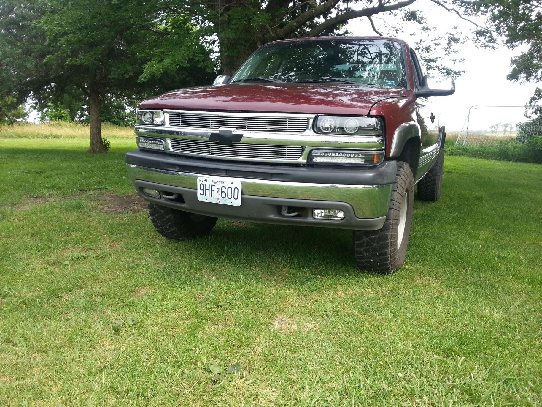

I got it figured out. It was actually a problem with the lights themselves. They were the worst quality parts I've ever seen. Just cheaply made all the way around. Here's some pictures in the attachments.
Attached Thumbnails Suburban LED Bumper Lights-20140629_161519%5B1%5D.jpg   Suburban LED Bumper Lights-20140629_161504%5B1%5D.jpg

I'm not for sure of the brand actually. I just picked them up off ebay. This is what they look like though.
