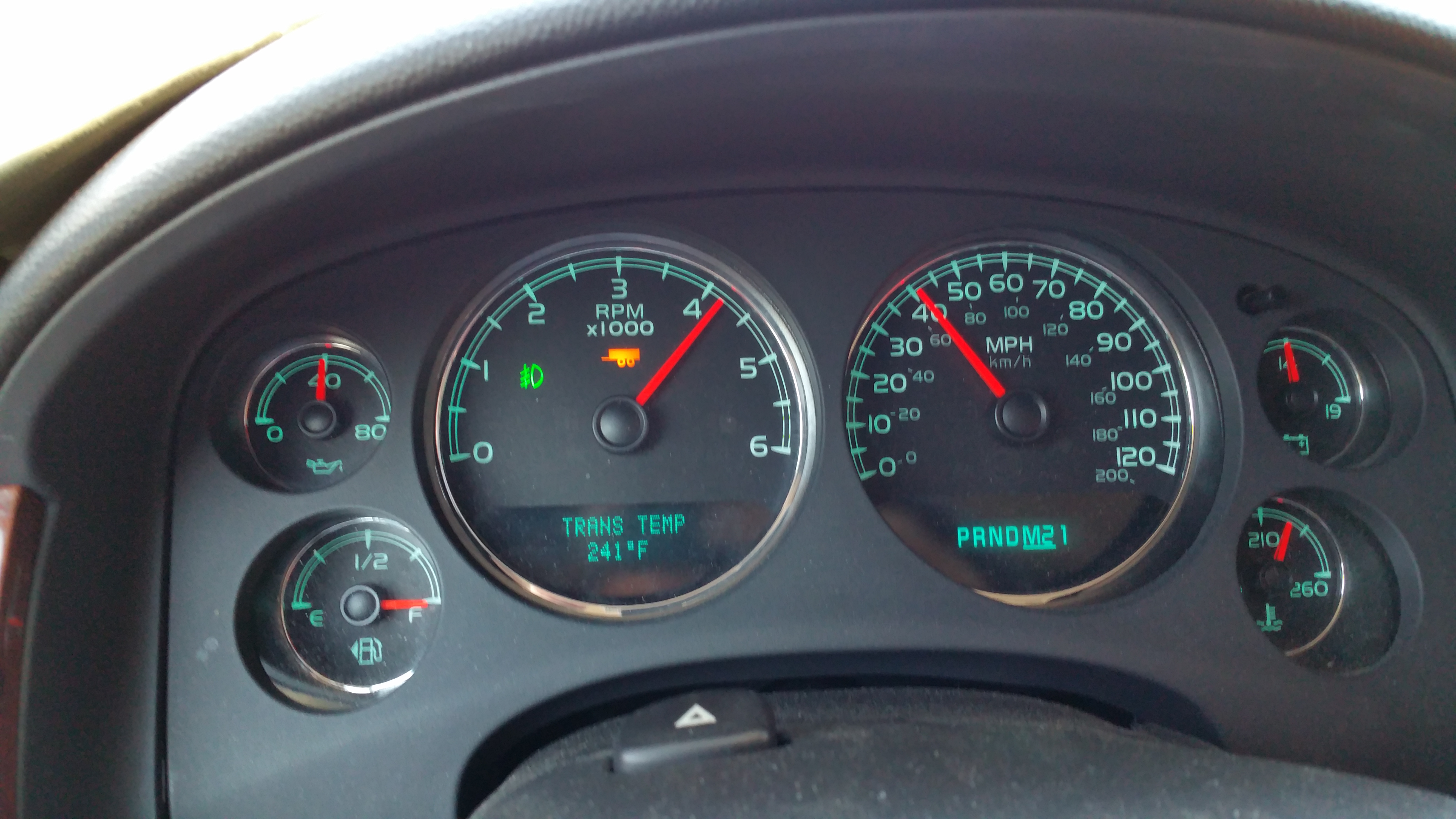

That graphic is old and completely obsolete. Normal operating temperatures for DexVI transmissions are 190-200°F. And on the GMT900 trucks, the "Trans hot, idle engine" warning only comes on at 265°.
DexVI doesn't even start to break down until it's over 275°. That's a substantial improvement over DexIII.

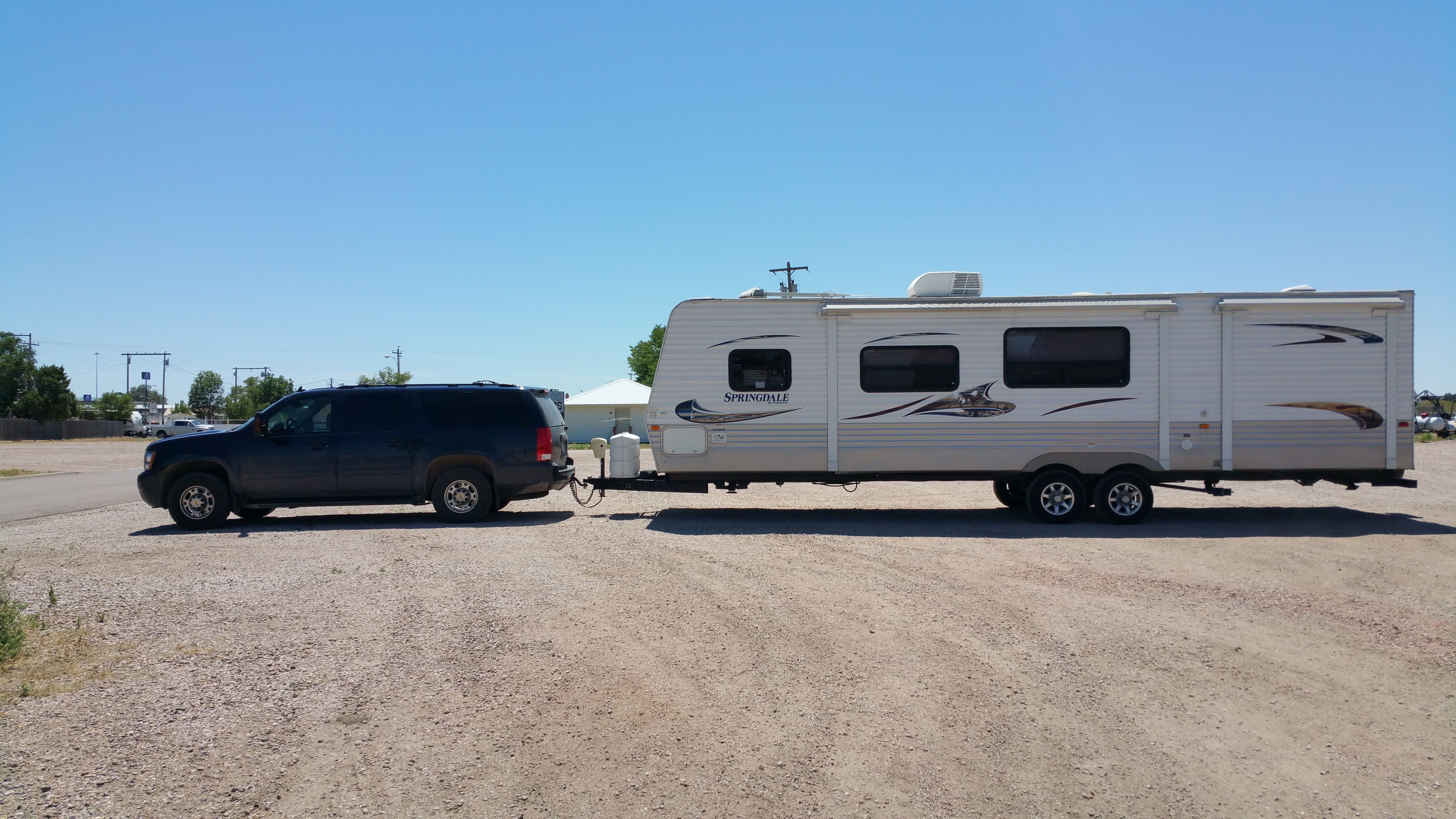

I was concerned about elevated transmission temperatures I was seeing on my 2500 when towing in the Rockies. I have a good friend who is a transmission validation engineer for GM. He works at the Milford proving grounds. When he was first hired at GM, the first transmission validation he worked on was the 6L80/6L90. I expressed my concerns to him and his reply was simply, "We did a lot worse during validation." With a wink and a nod.
I've done this to my truck several times. The only extra TLC I give it is more frequent fluid changes. 179k miles, original engine and transmission, and it still runs/shifts perfectly.
My current rig - 8600 lb trailer
