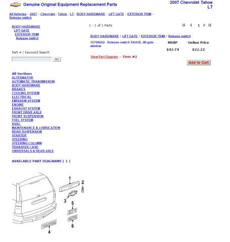

The part number is 15798062
GM parts direct has it listed ( see attached picture)
and it is also listed on Amazon
What I don't know is if it includes the rubber button cover?...

The part can also be found under D1994E, I tried looking up dealership parts departments but none seem to offer web browsing of parts on a Sunday evening, and can only be found during business hours M-S

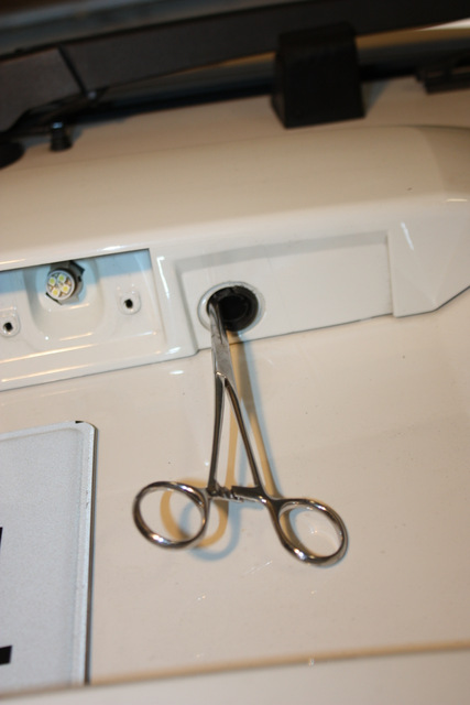

I looked at the new switch I had in hand and non-destructively dissembled it down to its 3 working parts, the main body, the rubber button cover and the inner button actuator, (FYI there is no spring)
I noticed the 2 retaining tabs that hold it in place and figured that is what have to attack to removed the old button from the outside...

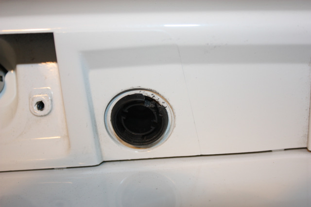

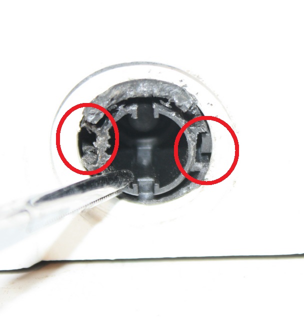

I pulled the old deteriorating rubber cover off the old button and could not see or access the tabs, so a pair of side cutters used to nibble away at the outer retaining ring eventually gave me a view of those clips.

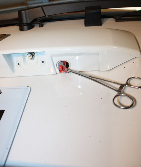

I used a pair of forceps attached to the old switch body to keep it from escaping into the body void, and nipped away all the ring until I could see and access both clips, I used a narrow screw driver to force the clips back on them selves and snap them off allowing the switch to come out the hole.
The wire harness/ connector is short so it would not come very far out but it was far enough to detach and reattach the new button. guided it back in and pressed it firmly from the outer edges and she snapped in and sat solid in the mount and it worked when pressed

Attached Thumbnails Tailgate Lift Glass Button.-rear-hatch-trip-panel.jpg   Tailgate Lift Glass Button.-rear-hatch-panel-removed-.jpg   Tailgate Lift Glass Button.-new-button-rubber-cap-inner-button-removed.jpg   Tailgate Lift Glass Button.-destructive-removal.jpg   Tailgate Lift Glass Button.-forcepts-saves.jpg

Attached Thumbnails Tailgate Lift Glass Button.-forcepts-saves.jpg   Tailgate Lift Glass Button.-get-those-clips.jpg   Tailgate Lift Glass Button.-old-out.jpg   Tailgate Lift Glass Button.-clip-runaway.jpg   Tailgate Lift Glass Button.-new-ready-seat.jpg
