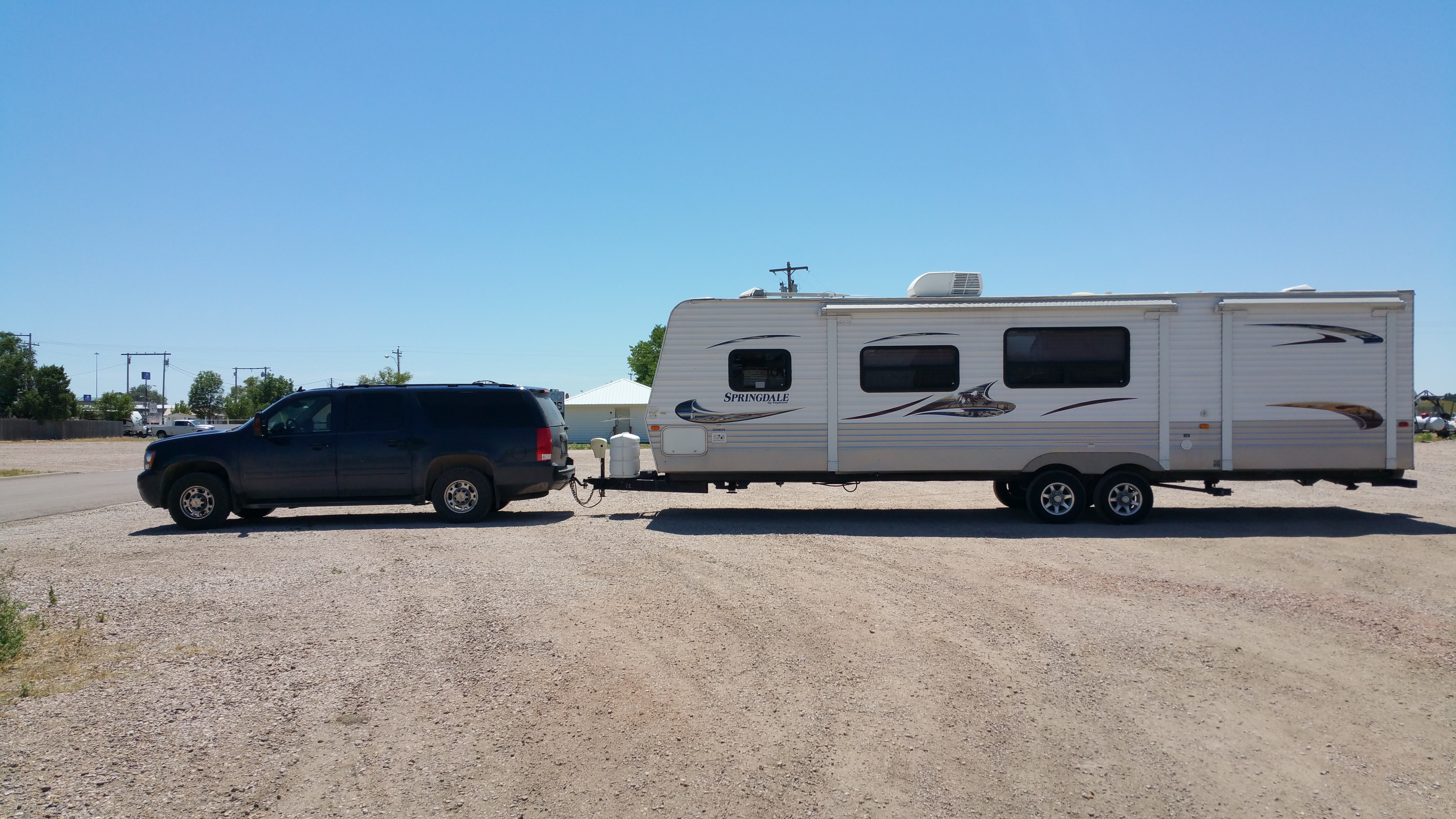

I actually prefer backing my 35' travel trailer compared to my 12' cargo trailer.
My single-axle 6x12 is a good size for me - I volunteer for a nonprofit, and the trailer holds all my gear easily, so I don't have to pack/unpack my Suburban.
Don't buy a ball hitch until you have a trailer. Then, you can measure the height you need on your hitch to keep the trailer level, and of course the proper ball size.
My behemoth tt:

I only prefer the 35-footer in terms of backing up. I usually put it where I want on the first try. The shorter length of the cargo trailer makes it less forgiving when backing, and I invariably over-steer, and then I have to pull forward to pull it out of a jacknife.
But yes, owning a trailer is more than just buying a hitch, sticking it in the receiver, hooking up and driving away.
What's the ball size? 2", 1 7/8", 2 1/4"?
What's the proper lift/drop you need on your hitch to make the trailer level?
Small trailers (without trailer brakes) use a 4-pin electrical connector. Your truck has a 7-pin. You'll need to buy an adapter/pigtail.
If you're looking at a trailer over 3500 lbs, it'll come with trailer brakes. Do you have the built-in trailer brake controller, or do you need to buy and install one?
If you buy an 8 foot wide trailer, you're probably going to want to get some towing mirrors - either ones that attach to your current mirrors, or replacing them outright. Notice mine, easier to see in the top picture. The OEM mirrors on your truck suck for towing.

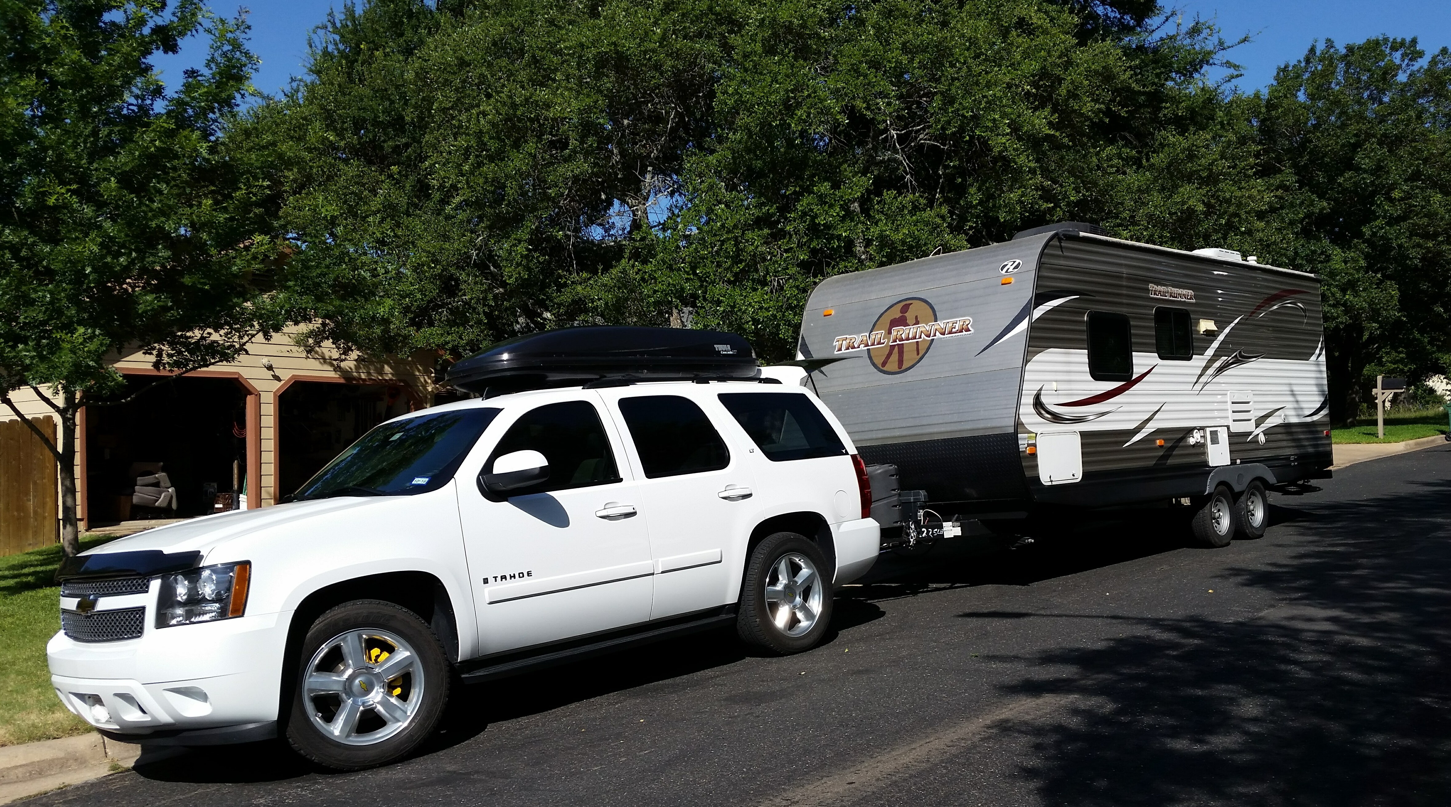

I found that having a weight distributing hitch made managing trailer pulling more manageable for myself even for shorter travel trailers...
As for brake controllers, I installed the Tekonsha 90195 P3 Electronic Brake Control, and have been very happy with its performance and easy of setup
Attached Thumbnails Thinking about a trailer ball mount and trailer-20160622_094035.jpg
