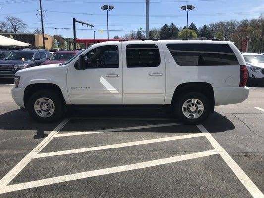

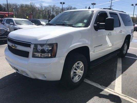

Hi folks - I’m the proud new owner of a 2011 Suburban LT 2500. Searched for a year before pulling the trigger on this very clean truck. It is in need of new tires and I’m looking for experienced recommendations. I realize it’s all subjective and personal perspective, but with all the brands out there I thought I’d see what people have had good luck with.
This is going to be mainly a family vacation hauler - not a daily driver. So mostly highway miles and I do expect we will see all 4-seasons so winter traction has to be considered. I’m also a value conscious consumer. I don’t mind spending money on something as important as tires, yet don’t want to throw money at a name.
Along the same subject I thought I’d like to upgrade to some fancier wheels and obviously this would be a good time. Just unsure of what direction to go as far as size. I know there are some “adjustments” needed and I’m concerned about a harsher ride if going with 20-inch wheels. They sure look right on this size vehicle. I find it interesting that the pickup trucks received a new wheel geometry design in 2011, but the 3/4-ton SUV’s retained the old design. Maybe they wanted to use up all the in- stock parts knowing the 2500 Suburban / Yukon was going to be discontinued.
Still at the Dealership waiting to come home..
Thanks in advance.
