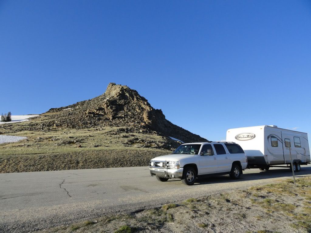

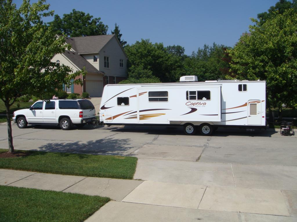

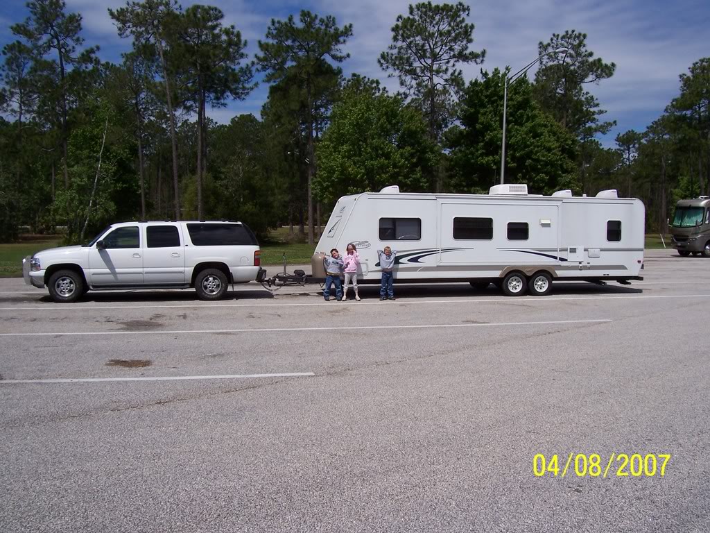

I towed much heavier with my '01 Burb all over the country, including the Rockies. Trailers as heavy as 7,000 lbs.
Your axle ratio will make a difference. I had the 4.10 gears. Took a little while to get used to the engine a little over 3000 RPM when cruising, but that truck now has 240,000 miles with the original engine and transmission.
Some of my past rigs...ranging in weights from 4550 to 7000 lbs, 27 to 30 feet long:

Nice pics of your burb and TT. That's awesome. I have towed with a manual tranny forever so I have to ask: I have the tow mode button on the end of my gear shift, is that sufficient or do I need to manually shift to 3rd and keep it there? 3rd all the time? Or just hill country? Thanks.
