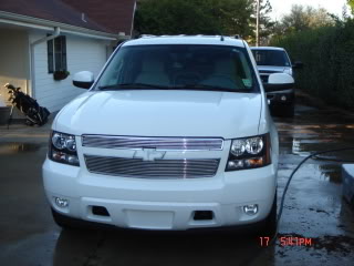

I upgraded to the OEM 20"s yesterday which I bought on EBay recently. My question is in regards to the Tire Pressure Monitors (TPM). The Seller on EBay stated that the TPM were removed but the TPM stems were left on. I'm not real smart when it comes to these technical things on vehicles but I thought I was going to have to take the TPM off my OEM 17"s and put them on the new wheels. I didn't have a chance to take them to the dealer to do the TPMswitch but decided to put the 20"s on anyway. Expected to get the ERROR message on the Dash when I scroll through the DIC but to my suprise I didn't. Is it possible that the guy left the TPMs on or is the stems left on enough to give a reading to the DIC??? My 17"s had the Metallic color TPM's and I know they also make Black TPM's. I have some close up pics of the wheels and the Black valve stems if it helps any.

Testing some picture posting methods. This may or may not work.
