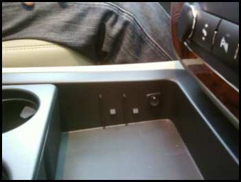

I read up on a few articles that talked about unlocking the Navigation directions entry while driving above 5 mph. So I decided to put a switch in myself in my suburban. Works like a charm. The switch is on all the time. When I want to enter directions while driving, I cut off the VSS using the switch and the menu items become available. Here is a picture of the switch and location I placed mine. I purchased the switch from Radio Shack. http://www.radioshack.com/product/in...ductId=2062523
Just figured I would post this as a $6 option instead of the lockpick which I heard has many issues for the 2009s.

What wire do you put the switch on? can you take a picture of the back of your unit? Did it also unlock the DVD viewing while in motion?

For my truck the VSS wire was connected to PIN 5 on the C4 radio connector. If you do a search on OEM navigation install, there are plenty of discussions regarding the location of this wire with a few diagrams and pictures.
It does not allow for video in motion just the navigation directions entry.

That's the exact switch I wired in to my Wrangler for when I take the doors off (to keep the dome light off)
If this mod works, I will be doing it!
I also like your center console more than the one in my LTZ. I need to find that one and ebay my LTZ wood grain one... the LS/LT one holds more stuff and is better at doing what a car should do... HOLD THINGS.
Where is the easiest place to tap this wire? behind the unit or is there a place under the dash?
I even like your hidden switch location, it's easy to reach, but not really visible to the driver...

The location of the VSS wire behind the radio is where I would tap into it for the switch.
