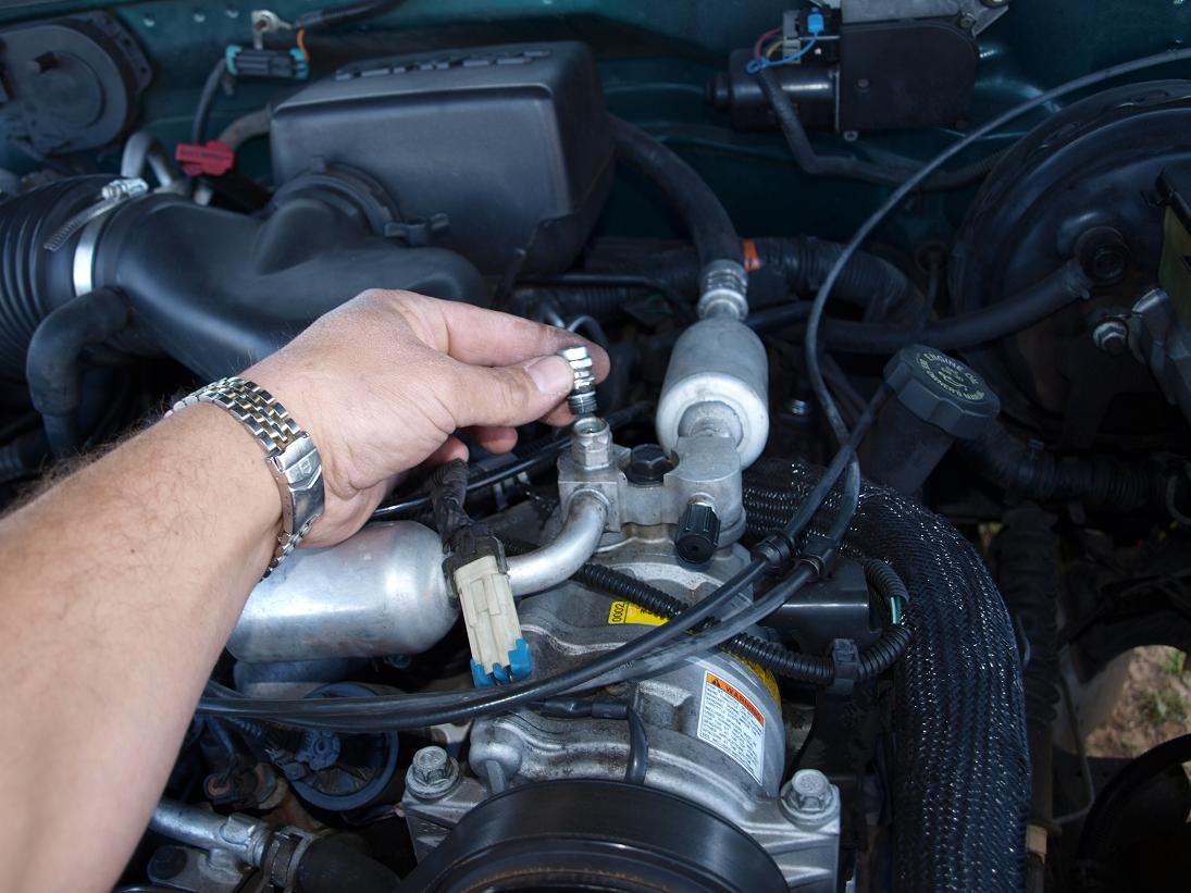

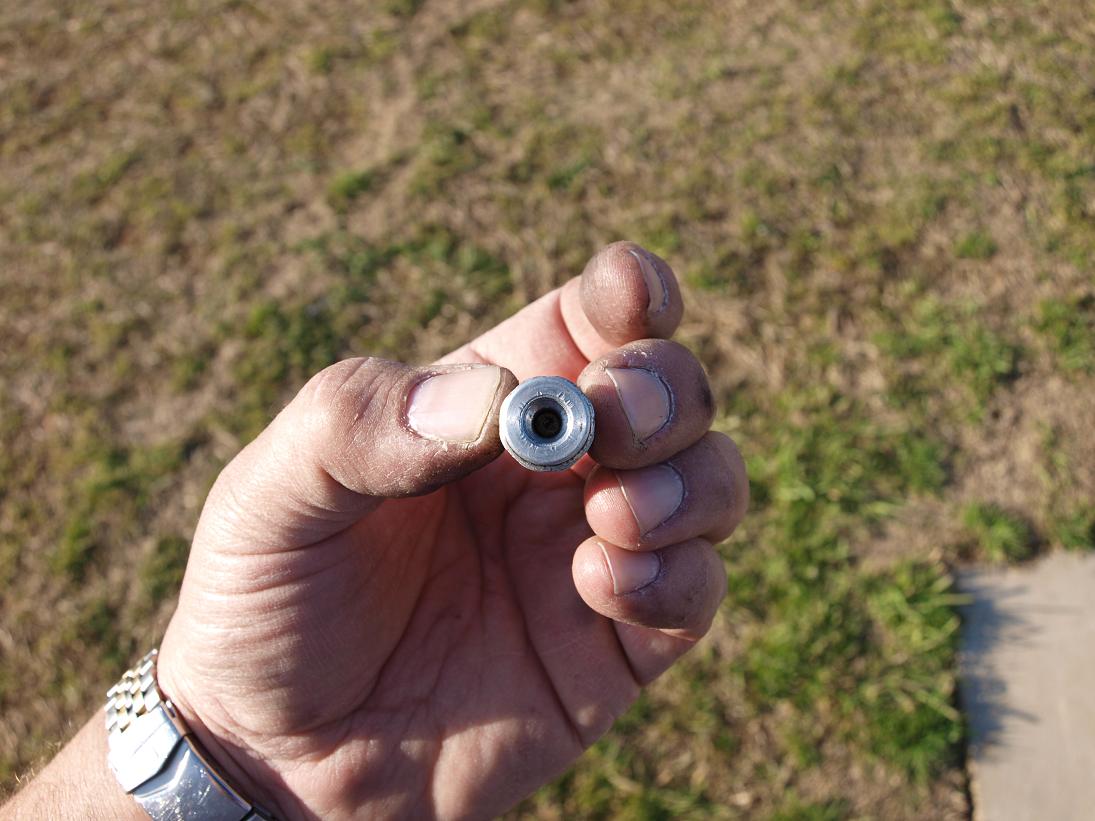

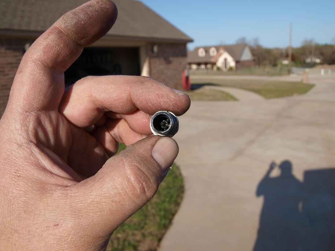

I need one of these. What is the technical name of it and where do i get it?
Off the High side on the A/C system.

I think they call it a quick connect charging port, I think you need to get it at the dealer.

maybe not the dealer? Is this the same?
http://www.autozone.com/autozone/cat...ndName=Santech

Just for the record, Autozone can order them, and O'Reily has them in stock. I paid $4 for it. Now time to recharge the system again. Both dealerships that I talked to said that they don't sell just the valve, you can only buy the whole assembly through them. (for $125)
