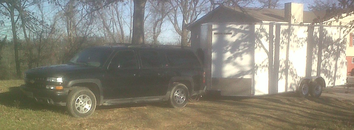

Here is the trailer that made me decide to go ahead and buy a P/U. My 05 K1500 5.3 is less capable than what you are looking at, in terms of torque, final drive ratio, and rear axle rating; but my real concern is sway at highway speed and not enough margin for error on tongue weight. You might not have the tongue weight issue with your TT but you will definitely need sway control.
Honestly, if the items you are most concerned about are navigation and rear entertainment for the kids, these are things you can do aftermarket for a few thousand dollars if you do not find them already in a 2500. Since you are looking for a used one I would look at it that way, buy whatever is closest to what you want and then install whatever radio and TV screens you want.
If you do not need the third row seating or interior cargo space of the Suburban, you might consider a Silverado. You can get more towing capability with the bells and whistles you want.
