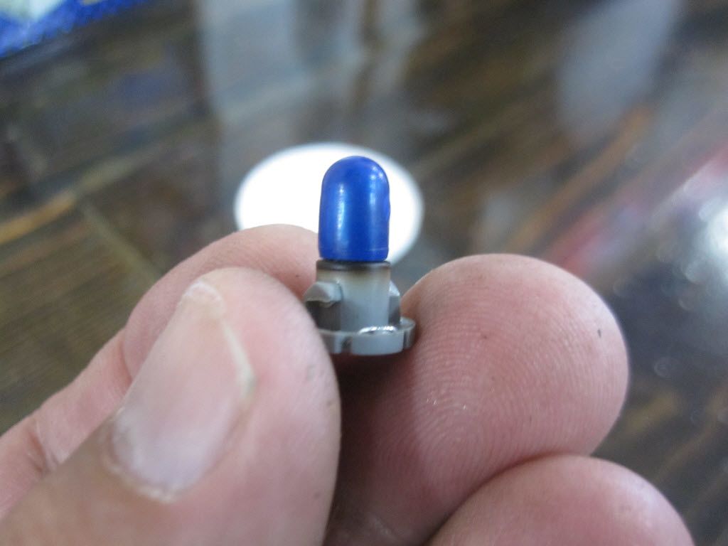

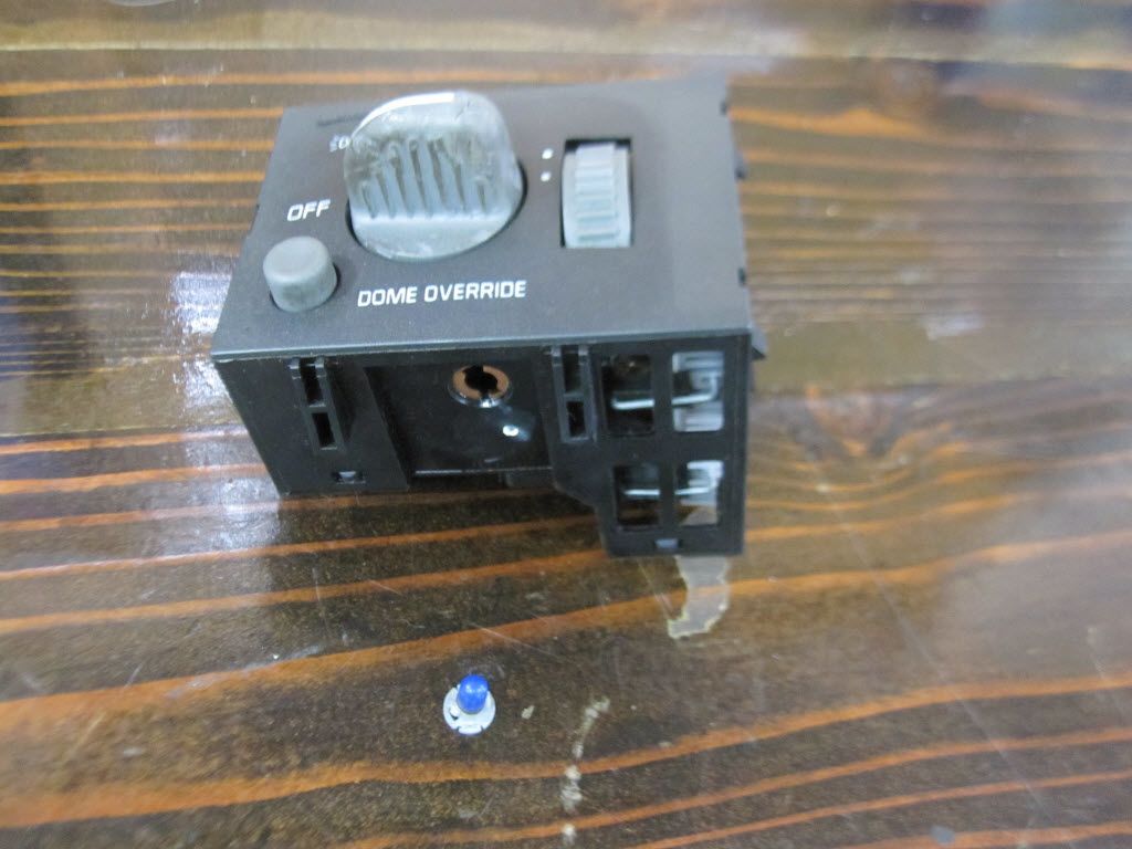

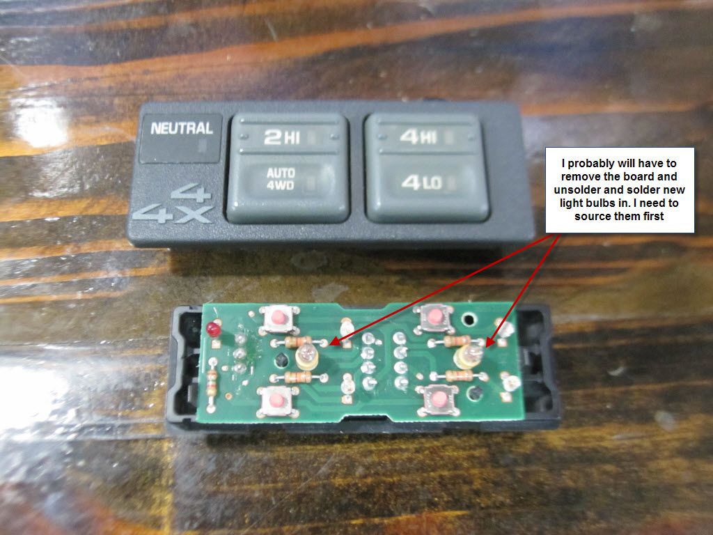

I need to figure out what light bulbs to use to replace the burned out bulbs in:
- 4x4 selector switch
- Dome override / light switch housing.
Pictures attached below

I couldnt find exact replacement, but I did order some LEDs off eBay that did the trick., they had nice leads and I simply soldered them in......my recollection is that these are 12 V here, but you can easily confirm that..

Also, why you are at it, get a magnifying glass and inspect the series of 3 joints on the short end of the assembly... (left side in your photo).. and touch those up..they are notorious for losing continuity over time.
