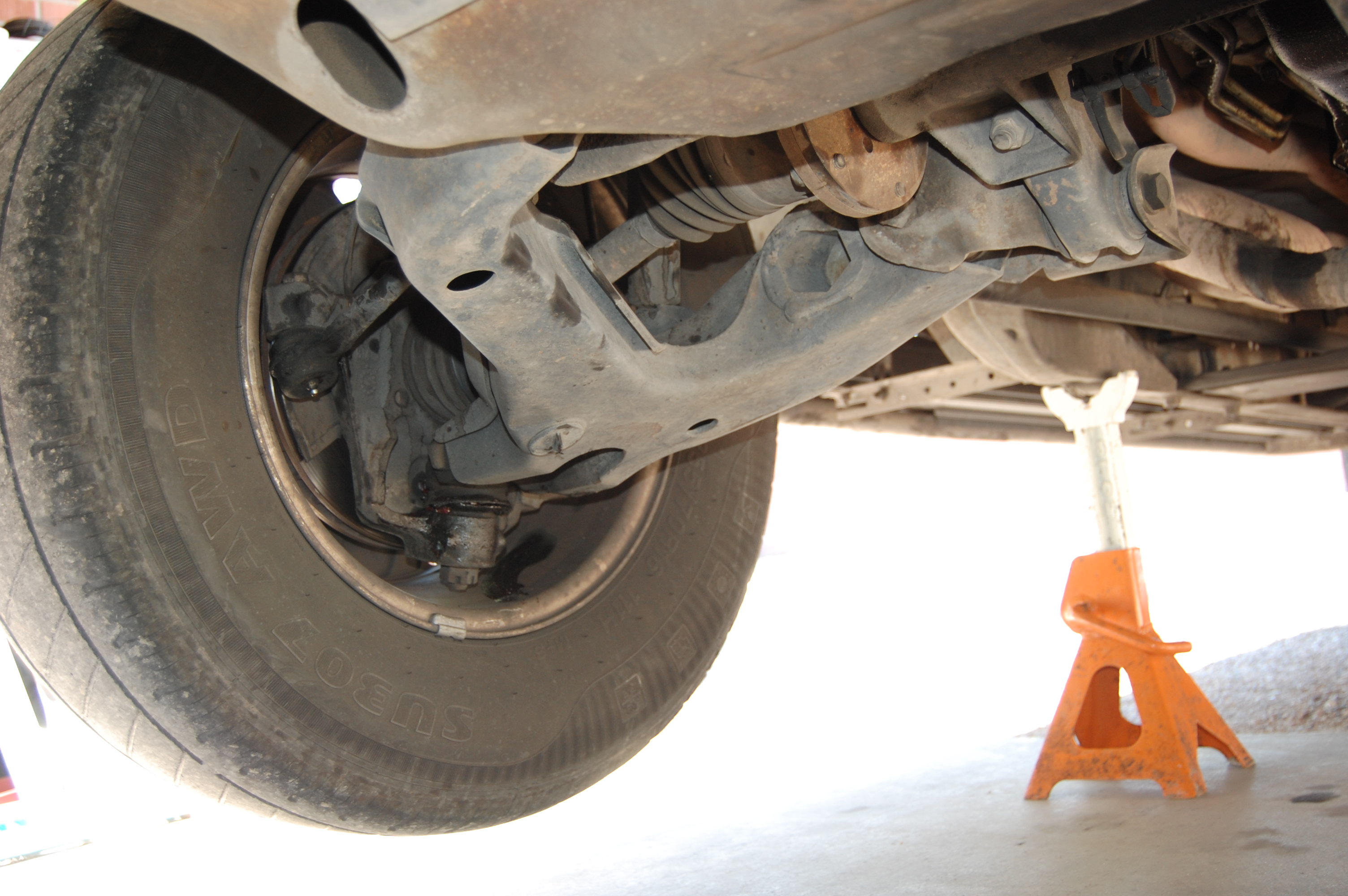

I am trying to find parts for my 1997 Chevy Tahoe 4d LT 4X4.
The ball joints and bushings are shot and need replacing.
As far as I know, the front end parts have not been replaced since the vehicle it was new. The lower arm is where I have gotten stuck as to what parts to order. There are three different types for the control arm. Stamped, welded, or forged. I am not sure what mines are. Here is maybe a hint; the front springs are torsion bar, not coils, if this is any help. There are three diameters of the lower ball joint.
VIN 1GNEK13RXVJxxxxxxx where the lower case xxxxxx is the serial number redacted.
Is there anyone could help sort this out?
Thank you.
Old Feb 25, 2017 | 8:58 AM
post a picture of the lca

Ok, I have taken three photos and have attached them to this post. I think that might be the welded control arm, but not sure.

Hello everyone,
Continuing with the subject, I must change the front lower ball joint and I am in doubt whether the control arm are forged or stamped. The control arms are the same as the photos.
So I bought K6477 (Ball Joint For Stamped Type Arms) or K6509 (Ball Joint For Forged Type Arms)?
Thanks.
