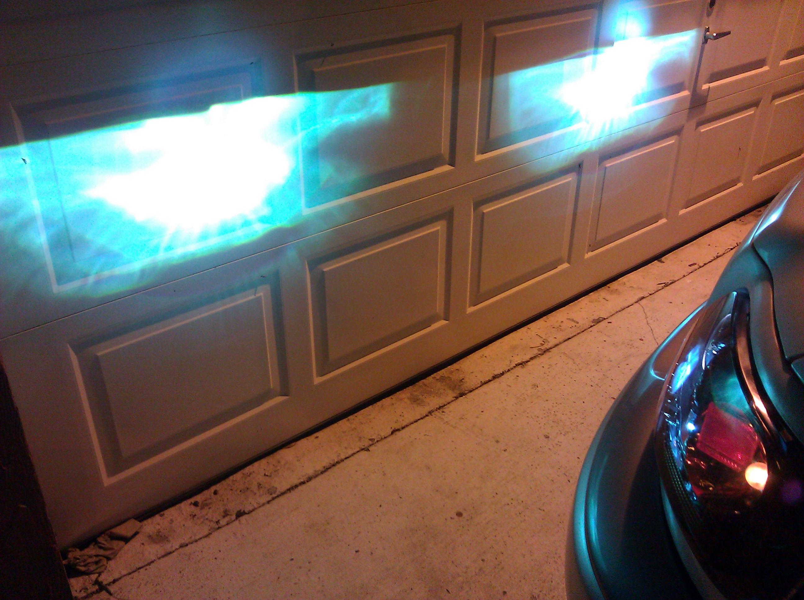

...i just replaced the stock lights these sonar (spyder halo head lights) come with, with some inexpensive HIDs i found on eBay... (for $37 lets see how this set holds out in the long run) the brand is Xentec black slim ballast (35W 8000K) after all the mixed reviews ive read i was a bit skeptical, but at under 40 bucks, what the heck.
Let me tell you i wasnt disapointed, the kit is real easy to install, ballast is smaller than the palm of my hand, and bulbs fits in the projectors well (only minor modification needed is to cut a small hole to pass the wires)... and boy do these increase visibility significantly.
If i would do anything different, perhaps maybe get a different color, like 6000k or maybe even something whiter like 5000k. Its not that i dont like the 8000k its not like an obnoxious blue, its mere a light blue, but i was trying to get a bright white with slight bluish tint. 5000k would be factory HID super white.
End of story if you buy aftermarket projector headlights to replace your stock reflective headlamps, its definitly worth while investing in a pair of HIDs.
i was boxed into my driveway so i couldnt get pictures of the road view, but it is pretty impressive, there is no glare on street signs.
