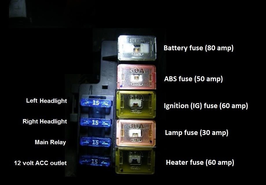

Having trouble: I have 2 cigarette lighters in this car one is a cigarette lighter and the other is a 12v power outlet. I'm having trouble do not know where the fuse is for the 12v power outlet that is located right beside the emergency brake lever. Any input would be helper.

You will find it on the fuse block under the hood.
