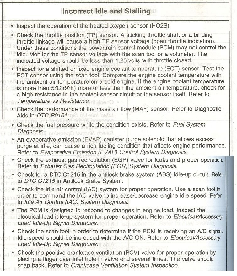

Below is a partial list of things Chevy says can cause rough idle and stalling. I have never had this problem
with my Tracker but I had something similar happen with my previous car. It would drive normally but the
engine would die every time I came to a stop. It would always start back up and drive off. Turned out the
EGR valve was stuck. Back then an EGR valve was $30. I think they run about $300 for a Tracker so I
wouldn't change it unless I was pretty sure that was the problem.
