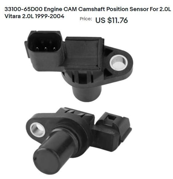

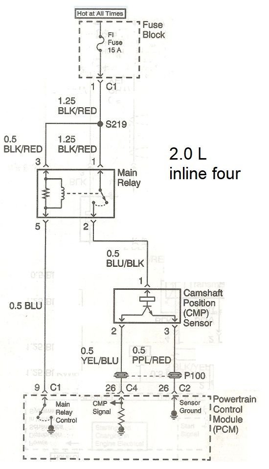

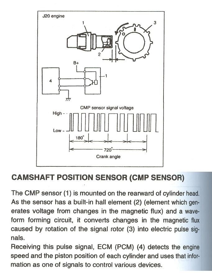

There is no reset button and it is unlikely an engine overheat would blow a fuse. The signal that tells the PCM when to fire the spark plugs originates at the Camshaft Position (CMP) sensor. These are known to be sensitive to heat.
The 2 liter engine uses a 3-pin Hall effect CMP sensor.
If you have access to an oscilloscope, look for a pulse train on pin-2 of the CMP sensor while cranking the engine.
I'm not the familiar with the 2 liter CMP sensor but I believe you can replace the black electrical part without disturbing the timing.
I don't thik the part is very expensive but again I am not that familiar with the 2.0L.
