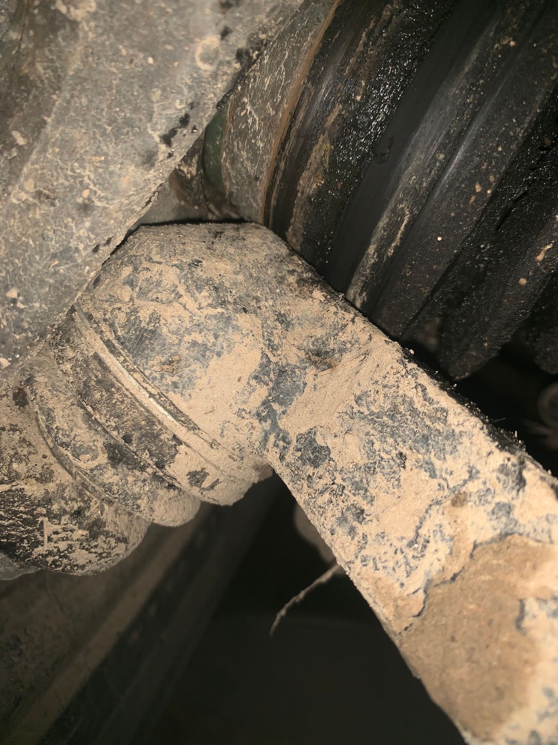

Hey guys I’m needing some help. My 2001 zr2 tracker I just bought it and the cv axel is rubbing the top of the ball joint on both sides causing the boot to be torn off. Not sure what’s going on. Stock no lift.

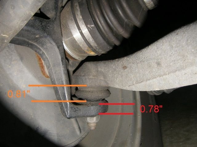

This is the passenger-side clearance on my 2001 4WD.
I can slip this 5/16" dowel rod between the axle and the top of the control arm. If your ball joint has 5/16" of slop it will be easy to
see. Jack the wheel off the ground a few inches. Have someone use a 2x4 to pry up the tire while you watch the ball joint.
If the ball joint has play the whole control arm needs to be replaced as the ball joint alone is not replaceable. But I
suspect this is not your problem. It seems more likely the previous owner replaced the axles with the wrong units.

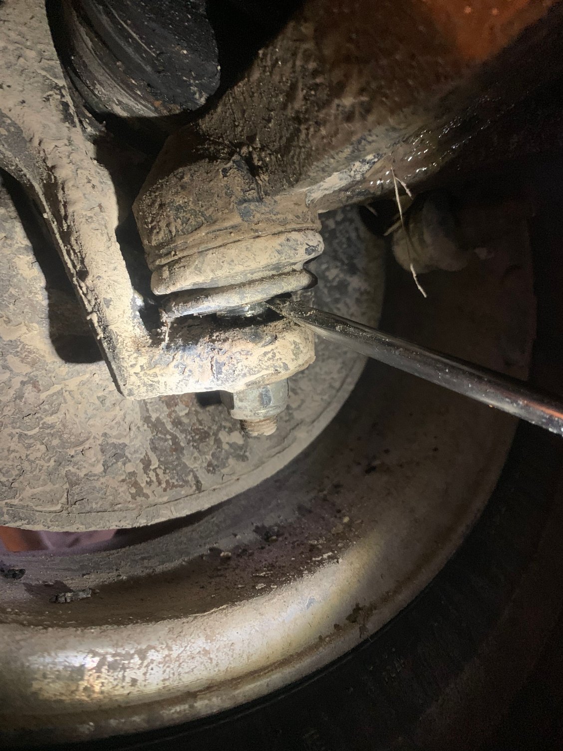

I think the balljoint spendal is to big for the hole maybe? That’s not letting the control arm go down far enough? Could it be the wrong control arm?????

I think you may be onto something.
On my Tracker the distance from the bottom of the control arm to the top of the spindle (in orange)
is just a little more than the thickness of the spindle (in red).
From your (excellent) photo it appears the distance from the bottom of the control arm is twice the thickness
of the spindle. That could explain the lack of clearance at the CV joint.

It’s crazy to think one can fit that close. I don’t think there is enough threads to press that one in to work and tighten up. And I don’t think it should be that hard to get in there.
