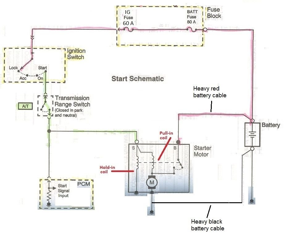

There is no starter relay.
This is simplified diagram of the starter circuit.

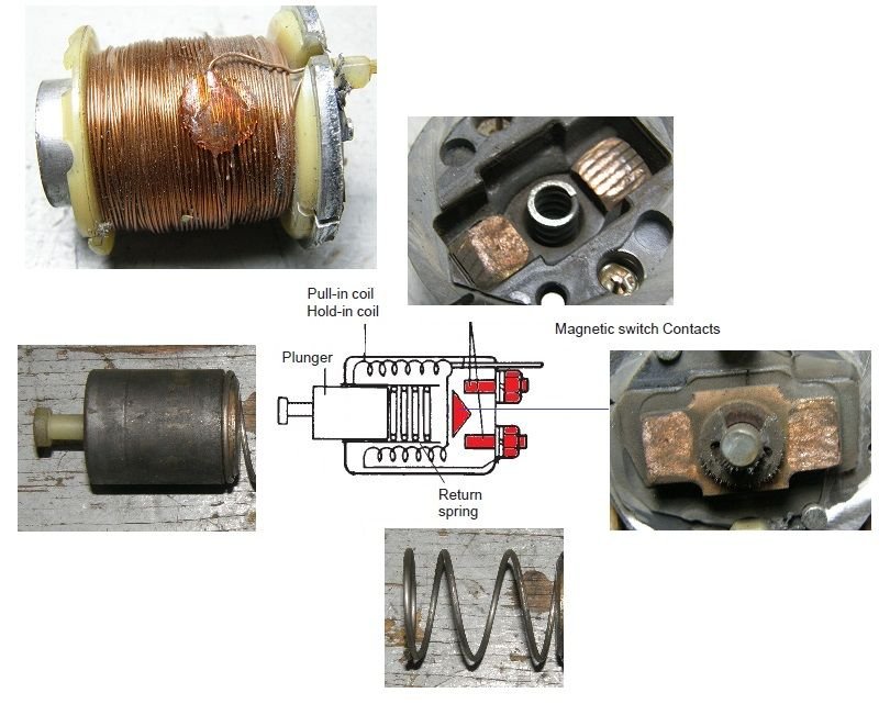

There is no starter relay -- only the starter solenoid. Just because the starter motor spins on the bench does not mean it can drawn enough current to turn your engine over. If the contacts inside the solenoid are burned or pitted they may present too much resistance to pass the required current.
The starting current for my V6 Tracker is over 500 amps.
I had the solenoid replaced at my local starter and generator shop. Been working great ever since.

tx, thats where my brain was going next, pulling sol and starter apart. cheers for pix
