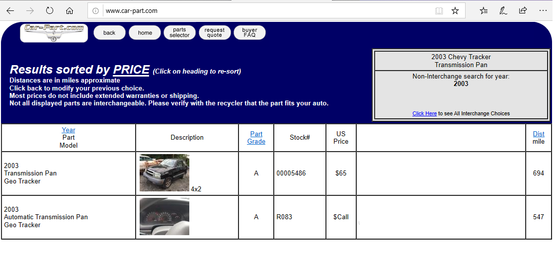

It is unlikely you will find these parts new. Start a search for used parts at Car-Part.com--Used Auto Parts Market. I found two transmission pans listed for a 2003 Tracker.
