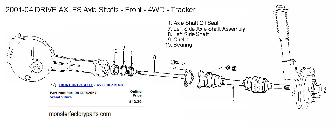

On my Tracker the "differential arm" is on the driver's side. Is your car left-hand or right-hand drive? Here is a diagram of the "differential tube." There is a bearing behind the axle shaft oil seal.
Differential tube bearing
