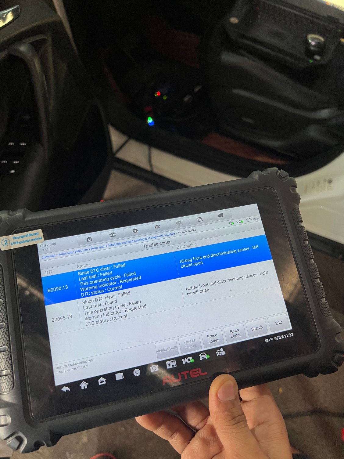

2022 Chevrolet Tracker,I知 looking for wiring diagram for front end impact sensor (SRS) my car kinda missing front end impact sensor, this is code that I got from scanner, anyone help please.
Fault code impact sensor
Fault code impact sensor and I inspect front end already but I still not find any impact sensor or wiring that connect to impact sensor itself, anyone help please.
I believe you are looking for a sensor that does not exist.
Full disclosure: I am not a mechanic and certainly not an air bag expert, but I do have the factory service manuals for a 2001 Tracker. Here is what the FSM says about impact detection:
The SDM is a module located under the center console. There are no impact sensors at front end of the vehicle.
