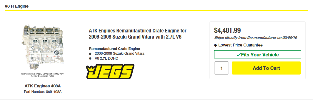

I would not risk thousands on an untried engine swap that may never work? If I wanted a bigger engine I'd bolt in the Suzuki 2.7L (185 HP). Here are the specs:
The H27A is a modern version of the H25A, a reliable displacing 2.7L (2,736 cc), coming from an 88 mm × 75 mm (3.46 in × 2.95 in) bore and stroke. Added VVT in 2006. The engine is tuned to achieve most of its torque at low revs at the expense of raw power at high revs, making the engine very responsive in day-to-day driving. It produces 138 kW (188 PS; 185 hp) at 5,350 rpm and 250 Nm (184 lbft) at 3,300 rpm.[3]
Applications:
· 2000 - 2009 XL-7
· 2006 - 2008 Grand Vitara **Only in North American Markets
Don't want to chance a used engine? You can buy a rebuilt one online. It's expensive but still cheaper than a conversion to a 4.3 Vortex engine.
