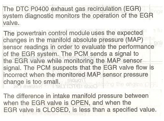

Hello Nate. The EGR code may not be caused by the EGR valve. Here's how the PCM tests the EGR valve:
As far as parts go, I get my generic parts from rockauto.com. For dealer parts you will need the Suzuki part number and order from megazip.net or partsouq.com.

It appears you copied that info from a factory shop manual, are they online or someplace I can buy one ? .
I'm betting my next step is to check intake manifold vacuum hoses as the fuel economy isn't very good , I'll have to see if I can find a P.C.V. valve or metered orifice .
