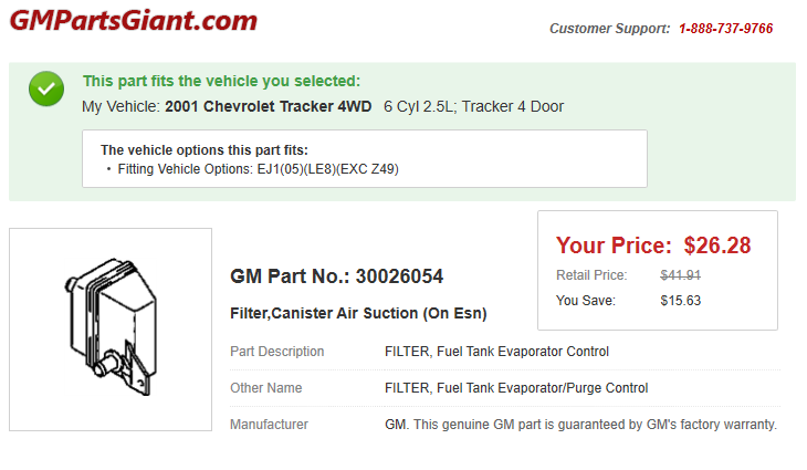

Thank you for clarifying the operation of the EVAP canister. I assumed that's how it worked but I have assumed wrong before.
This is the vent valve air filter tech2 was referring to. A clogged air filter may explain another mystery that has plagued me for years.

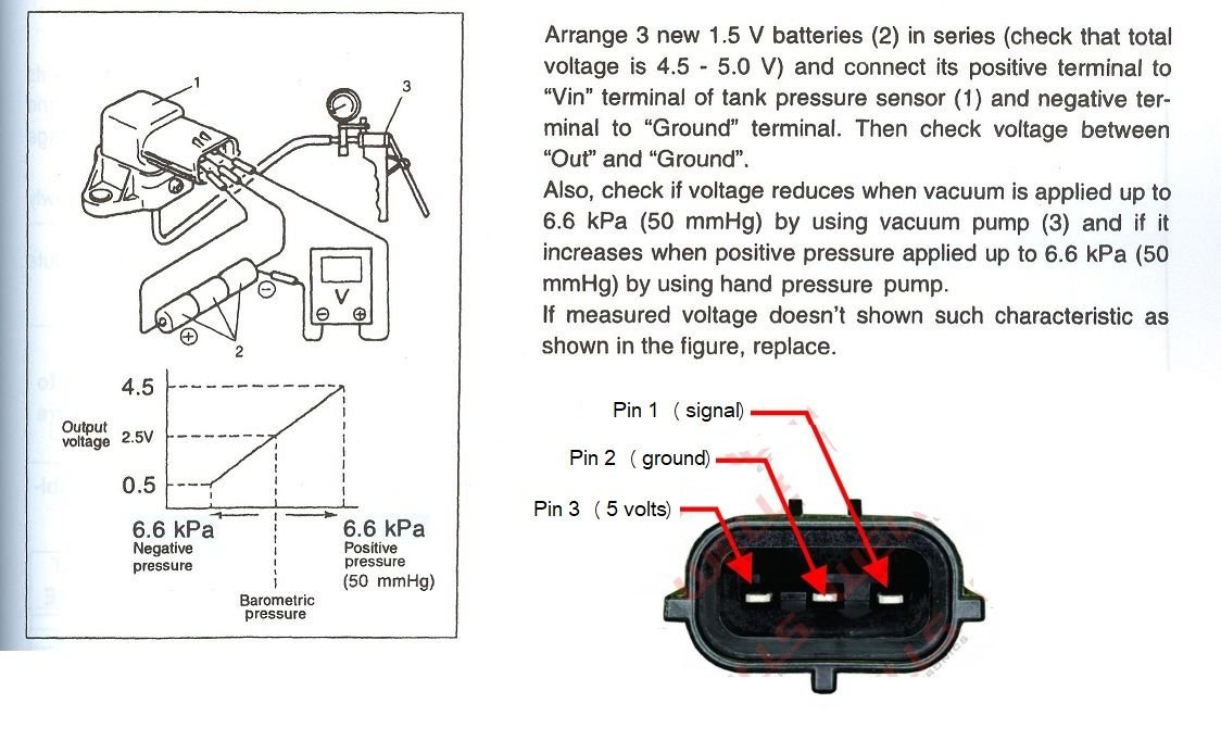

Here's how to test the fuel pressure sensor after it is removed from the fuel tank.

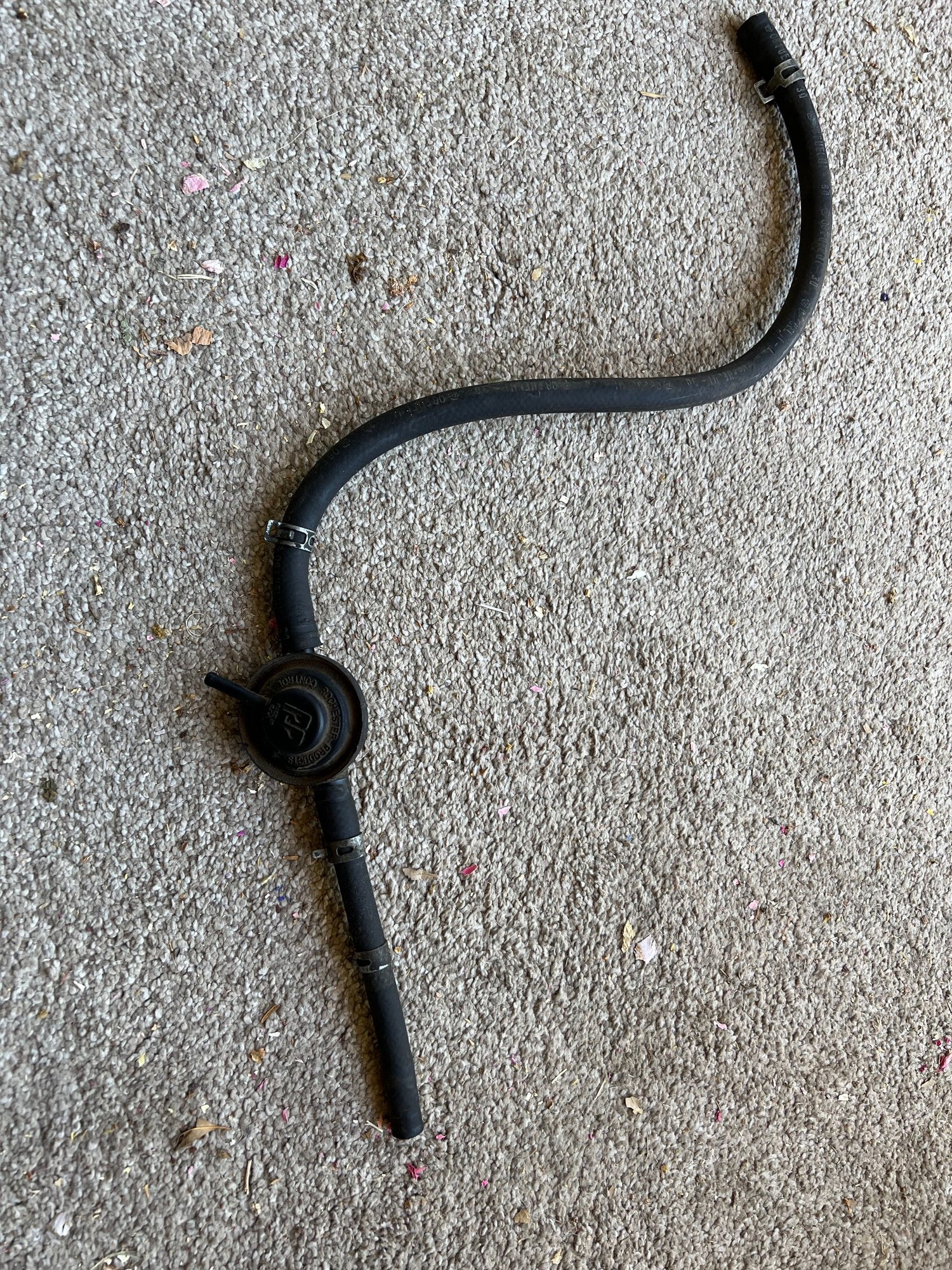

Update on this thread:
I'm still dealing with high fuel tank pressure.
1) I removed the fuel cap while observing the tank pressure on live data and the pressure dropped to zero. This leads me to believe the fuel pressure sensor is good.
2) I removed the hose from the EVAP canister coming from the tank. The pressure did not drop at all.
3) I removed the inline pressure relief valve (next component in the line running from the EVAP canister to the fuel tank) and the pressure dropped to zero. I took a picture of the part in question. The long hose runs to the EVAP canister, the short one to the fuel tank.
Three questions:
1) Is there a vacuum line that hooks up to the port on the top of this?
2) Is there a function test for this? I blew through it from the tank side and air did pass through. There was a buildup of pressure before the valve opened and the air passed through.
3) My concern is that I'm missing a vacuum line and that is why this valve is not engaging to depressurize my fuel tank...or is it just designed to work without any vacuum input once the pressure from the tank builds to a sufficient pressure?

My 2001 V6 does not have the part pictured above. As a test, can you purchase the same length of plain tubing and install it in place of the assembly shown above? If your pressure problem goes away maybe that pressure relief valve is faulty or should not be there in the first place. In my mind a pressure relief valve should not be in series with the tank and the EVAP canister. It should vent tank pressure to the outside air.

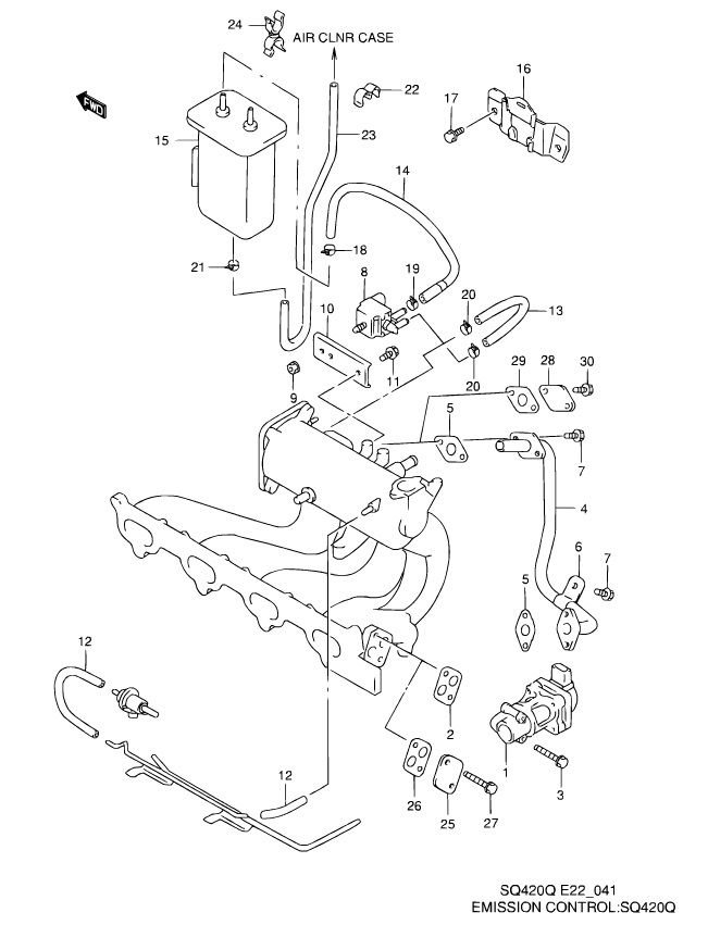

Is there a link to a parts diagram showing how it fits in the system? I'd like to study it if possible.
