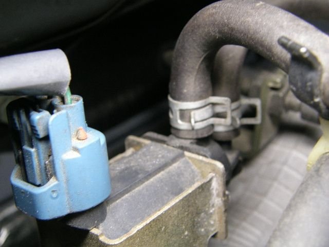

3. Was the "Tank Pressure Control Solenoid Valve" bolted to the engine and did it look something like the valve in the picture below?

I removed the evap canister purge valve and tested it. It was closed with no voltage applied and no air passed through. I applied 12 volts and it opened. This is also the picture that L84sky posted above.

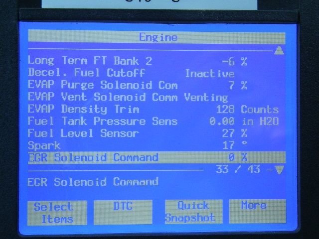

This a screenshot of my Tracker idling in the garage. Neither EVAP valve is being commanded
to do anything. The fuel pressure sensor is reading zero inches of water.
Driving down the road I noticed the purge valve was reading 7% open. I didn't expect a partially
open valve.

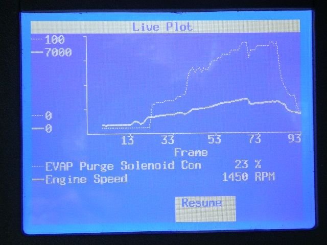

Plotting the purge valve command and RPM showed a definite correlation.
The purge valve closed when I came to a stop sign.
