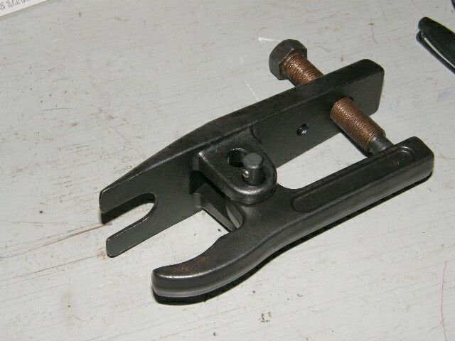

I'm assuming the CV joints on your car are similar to my 2001 LT 4-door. The driver's side is no problem. Remove the wheel. Unbolt the axle from the differential. Remove the snap ring. Wiggle the axle out. The passenger side is a different story. You have to remove the shock. This is a major undertaking. The fact that you think there is an axle nut involved suggests you may be in over your head. If you decide to go forward set aside two days because the learning curve is steep. One tool you absolutely need is the Harbor Freight ball joint puller (below). It also works on the tie-rod ends. You really should have the step-by-step repair instructions in front of you while you are working. Before you do anything read through this person's experience. https://www.suzuki-forums.com/thread...1999-gv.37983/ I will try to answer any questions.
