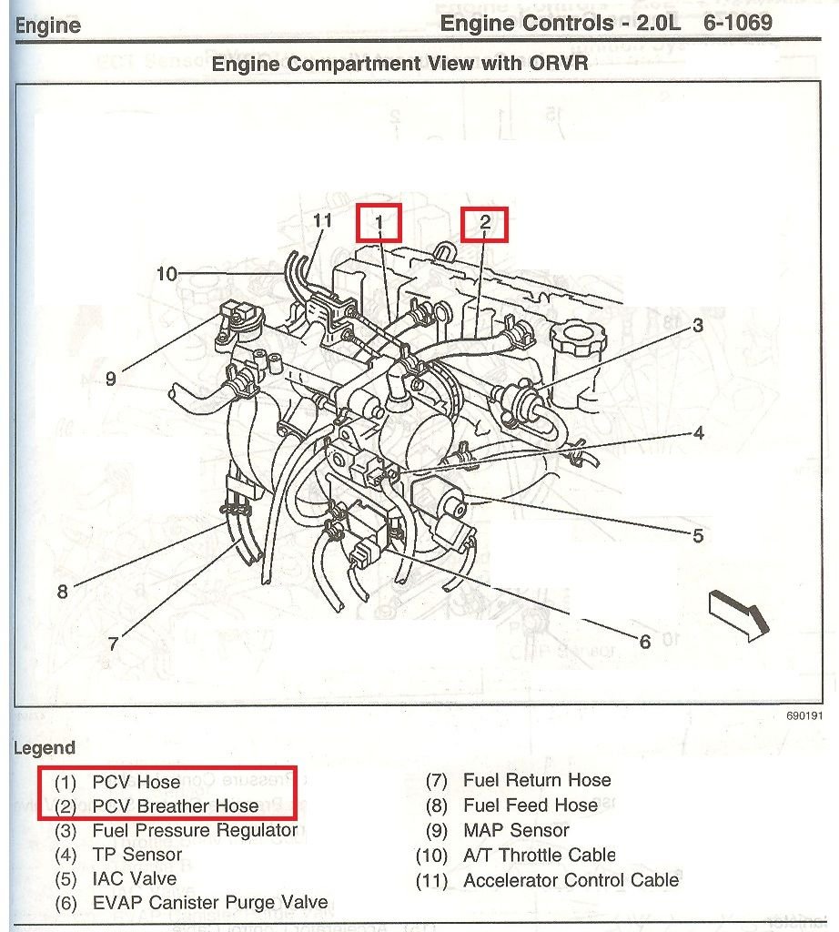

Question J20 Engie PCV Location ?
Got an image of where the PCV valve is on the J20 engine please ? .

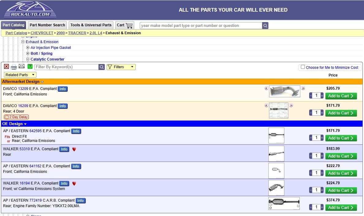

Trying to get this 2000 MY through Ca. emissions test, I need to forward catalytic converter too, can't seem to find it anywhere .
TIA,
Old Jun 12, 2025 | 6:54 PM
L84sky's Avatar
Joined: Oct 2018
Likes: 157
Not familiar with the 2.0 engine but maybe this engine view will help.
RockAuto says they CARB compliant converters (front and rear)

Sadly, when I try to order those CATS from Rock Auto they pop up a message saying they're NOT CARB compliant so they refuse to sell them to me nor ship them .
Go figure .
By copying the part #'s I was able to find the secondary Cat. and the gaskets on E-Bay, not the nifty springs and bolts however .
The primary / upstream cat. I cannot find anywhere, google shopping etc so I'm not sure what I'll end up doing .

I like using what I call "cheat sheets" : diagrams like this that I can take out to the job and scribble notes on as I go along .
