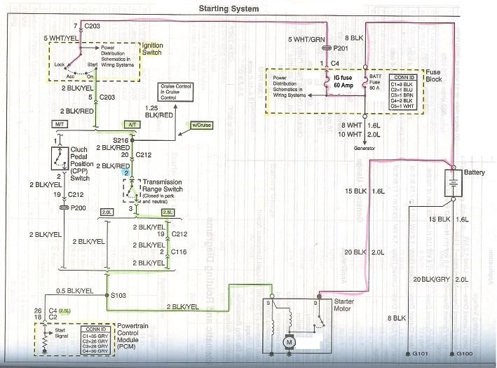

Just got my 98 tracker 4x4 and now it won't turn over turn key nothing any one have a wirer diagram? not sure of clutch switch any help thanks

This is the start circuit for a 2001 Tracker. Pin numbers and color codes may be different but the general start circuit should be
similar. The CPP is a "normally open" momentary switch mounted on a bracket above the clutch pedal. If you suspect the CPP
is not making contact when the clutch pedal is depressed, remove the connector from the CPP switch and jumper the contacts
inside the connector. If the engine cranks the switch is either bad or out of adjustment.

Thank you, I ran a lead directly to the starter and nothing verified there was voltage at the starter wire when key was turned . Hit the starter with a hammer and it started brushes stuck have a new one on order

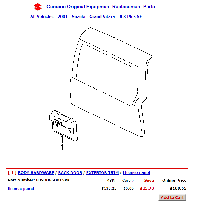

I'm now looking for some small parts looking for the 2 metal brackets that hold the license lights and cover the handle to open the tailgate if anyone know where or where I can get the spec so we can manufacture some ?

I could not locate the brackets you are looking for. This was a close as I could get.

Thank you for all the info I'm looking for Item #13 ,14 but looks like you have to get the whole piece
