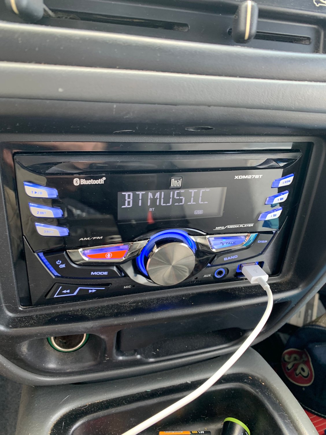

Thanks to a friend of mine the old crappy stereo has been replaced. Good riddance. That thing was junk.
