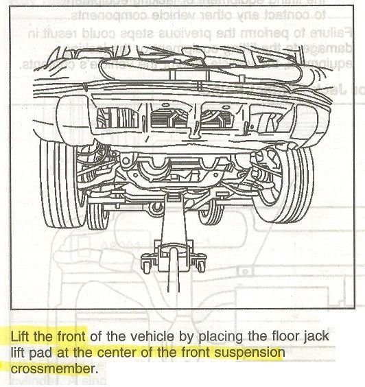

I want to jack up the front of my 2001 Tracker (both wheels off the ground) with a floor jack and need to know the best structure under which I can place the jack so I can get the jack stands into the correct position on either side. I used the differential housing to lift the rear end but the front diff is off-center, aluminum and obviously not an appropriate location. Any suggestions greatly appreciated. Thanks

From the 2001 Tracker factory service manual (FSM).
Thanks so much. Life would be so much easier with the service manual handy.
