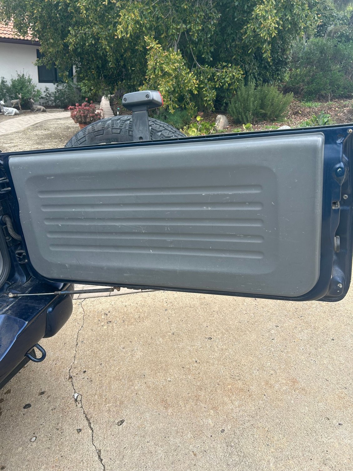

How does it come off? Need to reroute the backup cam. 2002 Soft Top.

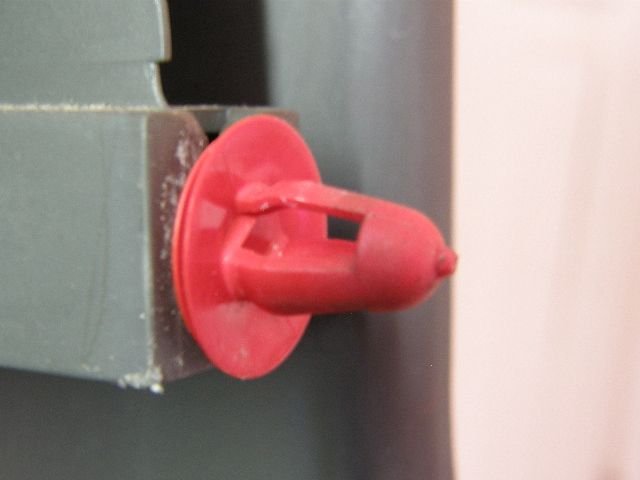

The door panel is held in place with plastic clips.

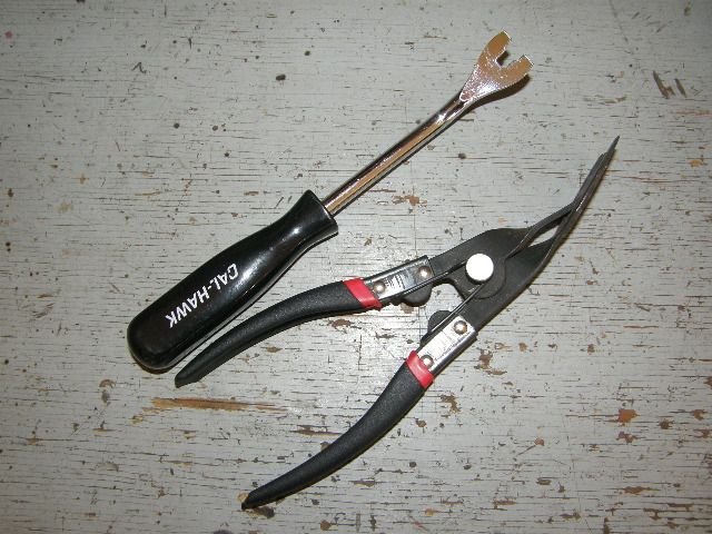

Body panel tools usually pop them out but a screwdriver will work in a pinch.

Those Toyota clips may work fine.
These are the clips I bought. If you're lucky the original clips may be reusable.

09409-08320 is the Suzuki part number for the Tracker. Any clip the crosses to that part number will work.
