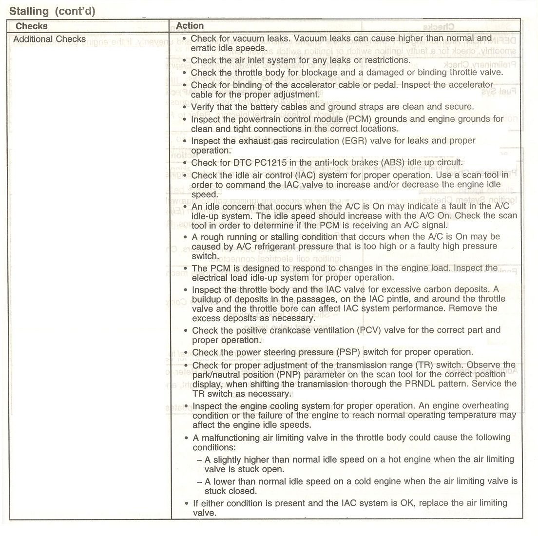

>> Could it be the camshaft sensor?
Yes. And here's a list of other things Chevy says it could be.

Thanks. I will go through each one and hope that we can solve this issue. Good thing that the weather is getting better so I have time to go the stalling problems one by one. Thanks again and I will post an update.
