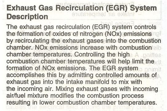

>> it stalls when I am at a light or stop sign
The EGR valve is commanded CLOSED at idle and opens at higher RPM's. If the EGR valve is stuck open the engine will stall when the car comes to a stop but will restart normally.
Tracker 101: intro to the EGR valve - Chevrolet Forum - Chevy Enthusiasts Forums

>> wondering if the egr valve is fairly easy to remove
I would try to isolate the problem before I pulled the EGR.
The EGR tube shown above feeds exhaust gas up to the intake collector. I would use the gasket between the EGR tube and the exhaust manifold as a pattern for a thin metal blocking plate. Install the blocking plate and drive the car. If the stalling problem persists the EGR is not the issue. If the car operates normally you can be pretty confident the EGR needs to be replaced.

>> I will try it and give an update.
Blocking the EGR tube will cause the combustion chamber temperatures to increase. Only do this for testing the EGR operation. It is not a permanent fix.

The higher combustion temperatures will not hurt the engine but will increase the production of NOx emissions. You can drive the car as long as you need to for troubleshooting.
