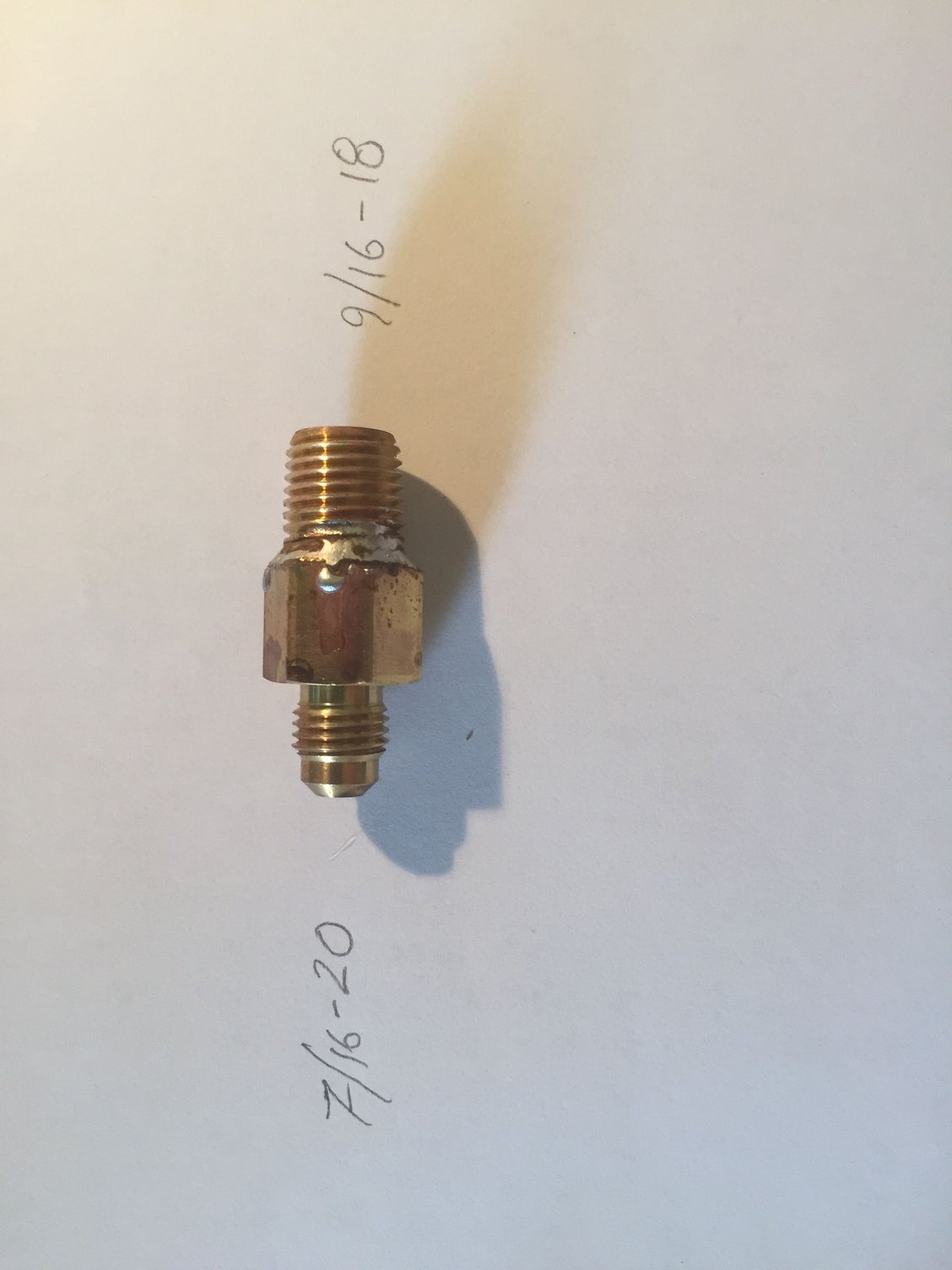

With several parts on order, herefollows the first cheap workable (but not recommended) approach:
As i had items on order and now i get to await delivery, carrying the fuel rail plug and the gage hose with the flare fitting in hand i went into a Home Depot and spent a good hour going through parts there, then an Advance Auto, and finally Ace Hardware.
At Ace i was able to find that the flare side seems to be a 7/16-20 flare fitting and the plug seems to be a 9/16-18. I must stress the "seems to be" because with plumbing and pipes and tubing there are so many variations it is ridiculous. There is the width, which can be standard or metric, there is threads per (inch or whatever) and there appears to also be the size of the actual thread itself. This took my prior frustrations working with plumbing fittings for the house to a new level.
I found what seemed to be a workable 9/16-18 union ("male to male") and a 7/16-20 flare to 9/16-20 female.
Because i did not want the union to get stuck in the fuel rail opening if the connection to the flare fitting gave way first when it came time to unscrew the adapter i was making (the hex nut being a part of the flare portion), i used my torch with MAPP gas to solder the two pieces together, after making some cuts in the flare fitting female side.
Once cooled i tested this assembly, and even though screwed in rather tight (glad i soldered them together), gas still leaked out through the threads. I could tell by the initial feel when trying to screw the adapter into the rail that it felt slightly loose.
So this is obviously something we can easily overcome using some Teflon thread-seal tape, but if you choose to go this route you must be very careful not to let any tape fragments get into your fuel rail or you will foul an injector. Use care in where you apply the tape and after removing the adapter, check the threads inside the rail for any fragments, brushing them out if need be. On the other hand, this solution only cost a little over $4.00 and a little time soldering. That item from Summit Racing was $14.95 PLUS another $6 or so handling alone...
I have a few items on their way to me at this time, probably by banana boat. As they arrive i will see what is needed to interface and post-
