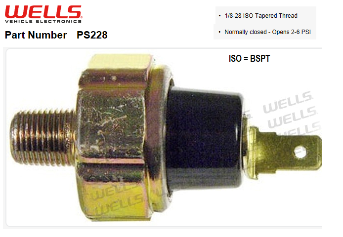

As far as I know all the threads on the Tracker are metric except the oil pressure switch shown below.
It's thread is IOS (International Organization of Standards) which turns out to be BSPT (British Standard Pipe Taper) whose threads are measured in inches.
A Google search found this adapter. With it I can connect an oil pressure gauge to my Tracker's engine block.

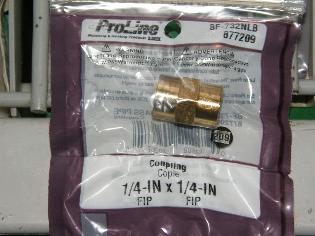

The $2 half-union below is what you want. The 1/4" flair end goes in the pressure gauge hose.
The 1/4" MIP end fits in the $4 coupling you are also going to buy a Lowe's.
Now you just have to connect the other 1/4" FIP end of the coupling to the 1/8 NPT on the Summit racing adapter.
Luckily for you the adapter for that is already included in the Harbor Freight fuel pressure kit.
