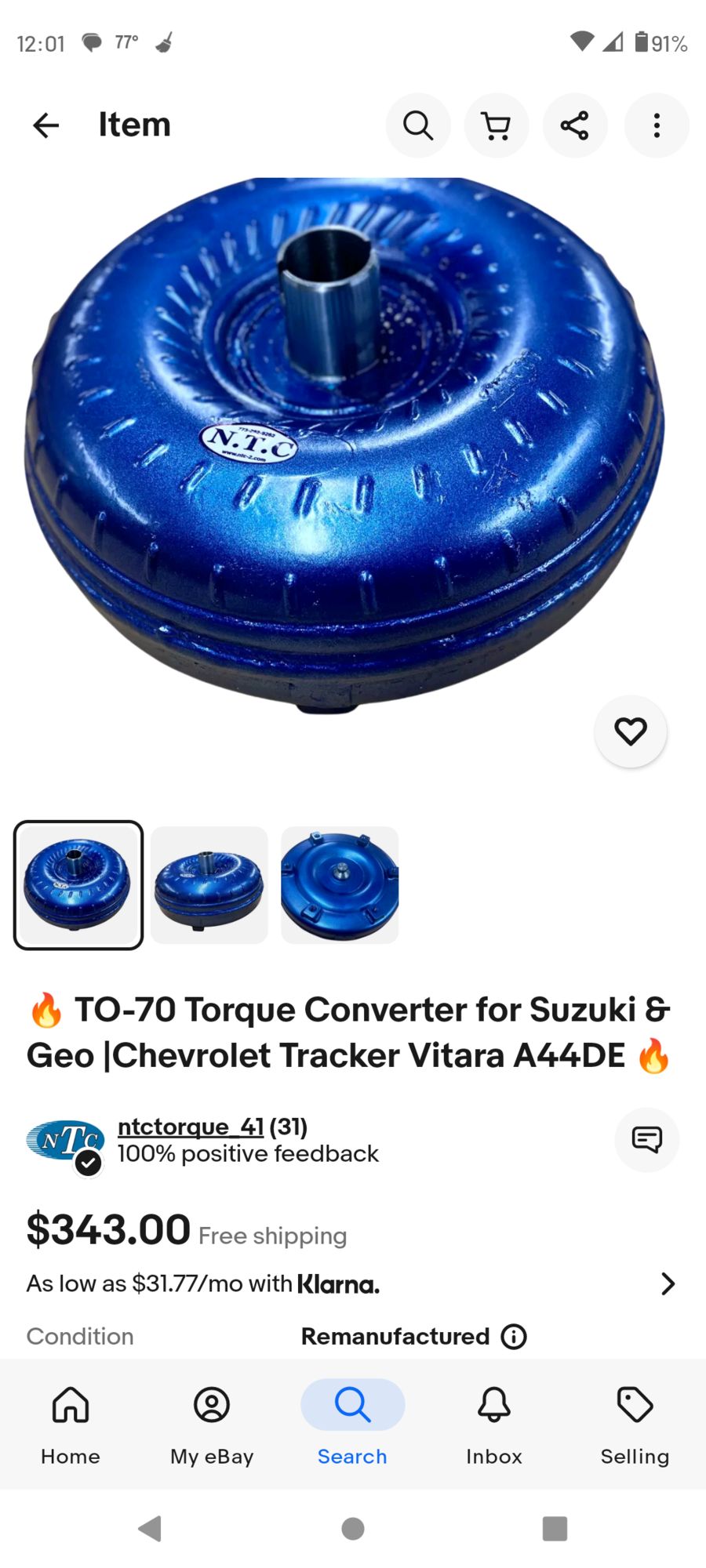

I have a problem the owner of the 2002 Chevy tracker 2.0l bought a new torque converter TO25 and it does not fit I do believe it needs a TO70. if somebody could help me out and make sure that is what I need I would greatly appreciate it .🙏
