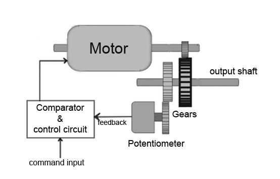

This is the cruise control servo unit. A steel cable pulls on the gas pedal.
Inside the servo the steel cable connects to a pulley on the output shaft. The shaft
only turns about a half rotation.

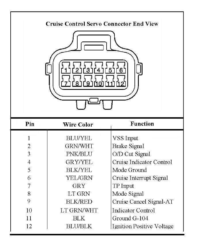

The servo gets its commands through this electrical connector.
These are the signals on each pin.

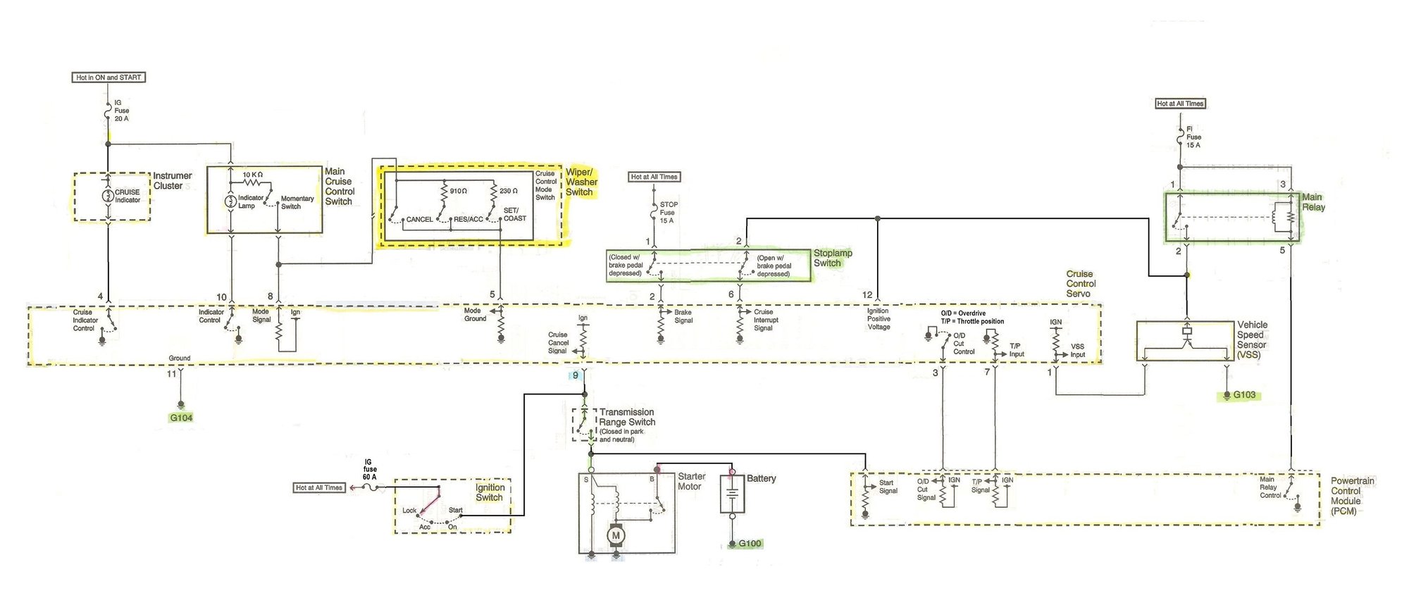

This is a composite of the entire cruise control system. Pin 9 deserves special consideration. Assume the shifter was accidentally bumped into neutral (or the clutch pushed in),
the car would start to slow down. The VSS would detect this slow down and send a signal to the cruise servo to increase engine RPM. Because the car is in neutral it continues
to slow down. The servo would very quickly drive engine into the rev limiter (6800 RPM). The Transmission Range Switch (or Clutch Pedal Position switch for manuals) prevents
this from happening. In neutral, the TRS or CCP switch sends a ground through the hold-in winding of the starter to pin 9. That ground signal immediately cancels the servo operation.
The full-size drawing can be downloaded at: https://www.dropbox.com/s/cwoipose9f...odule.jpg?dl=0
