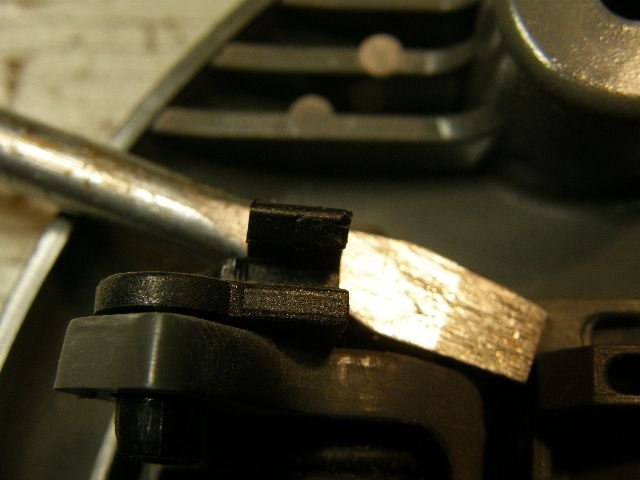

The mirror cover has to be pulled straight back.
I used these body panel tools but any thin pry bar should work.

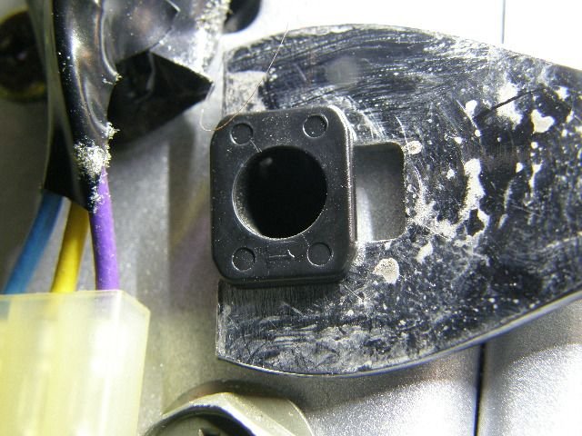

The mirror cover is held on by two plastic rivets.
The rivets pop into these two holes in the door frame.
When I pulled off the cover off one rivet stayed with the cover and one stayed in the door frame.
I used the rivet remover tool to recover it. Luckily neither the rivet nor the cover were damaged.

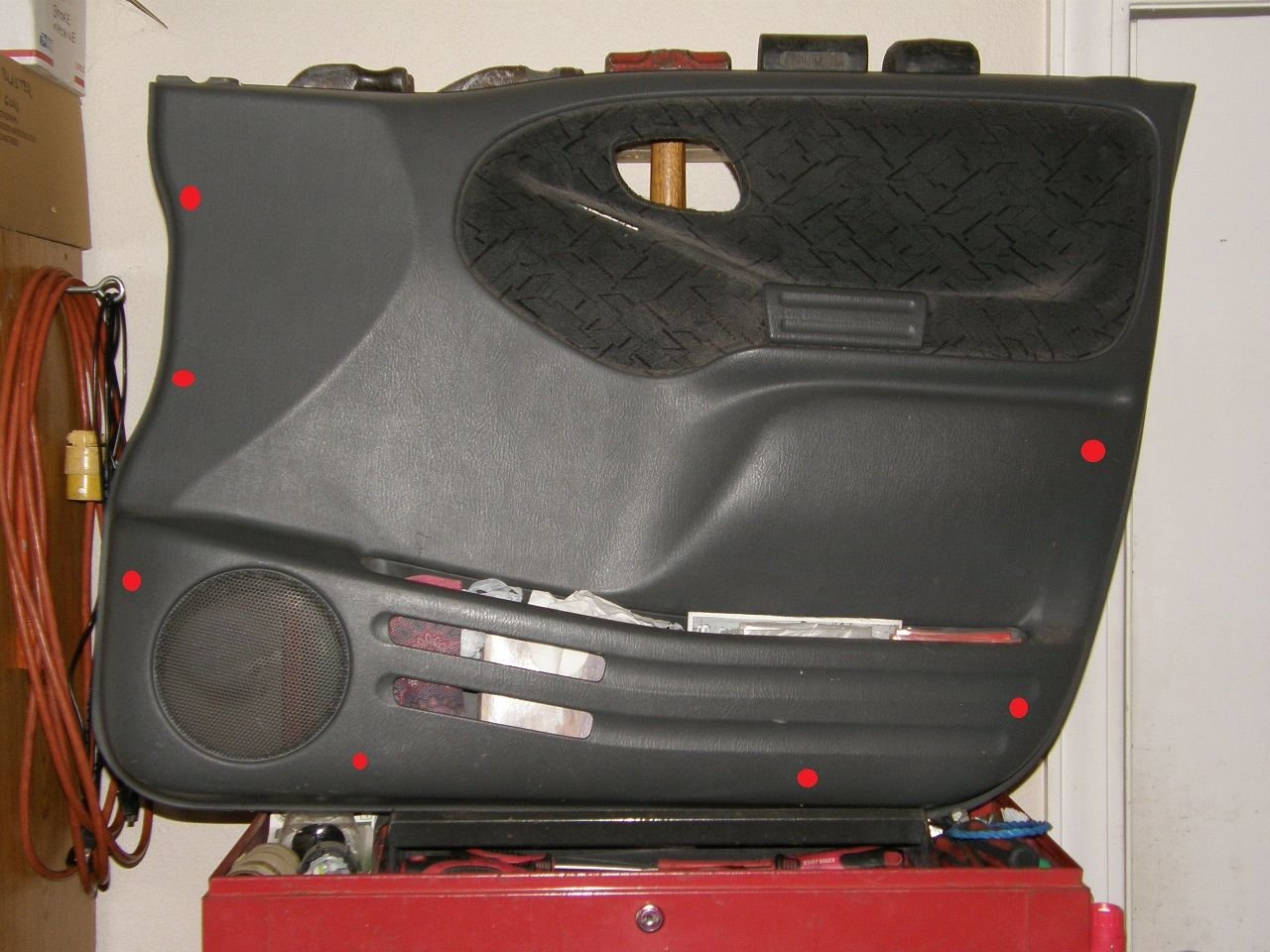

These are the locatione of the seven plastic rivets holding the panel to the door.
This is what the rivets look like.
New rivets are available on Amazon.

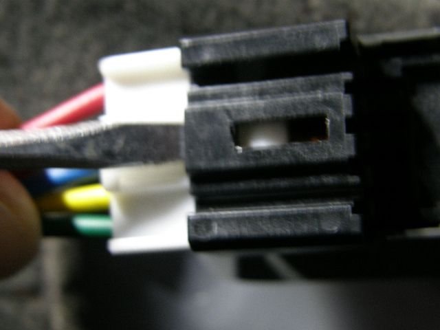

Pop the power window switch out of the panel.
Use a small screwdriver to release the locking tab.
I managed to remove the panel without any rivets getting broken.

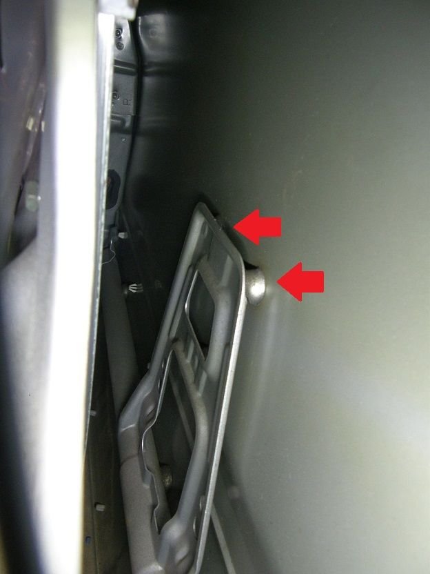

My door would "clunk" when slammed because the adhesive on the door stiffener had broken loose.
While I was in there I copied down the 5-digit key code stamped on the door lock.
