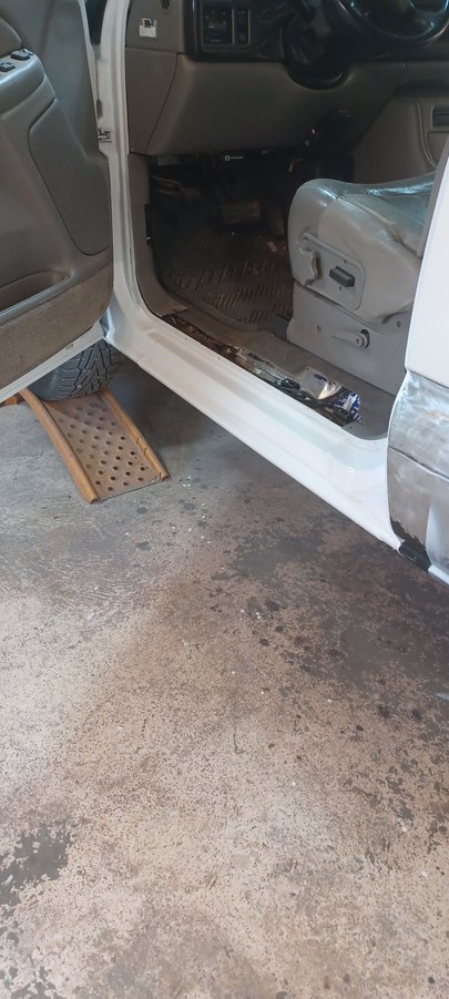

Cut off the rusted rockers and installed rocker covers. Structural adhesive on the top, spot weld on the bottom
passenger cab corner installed with adhesive, rockers ready for paint

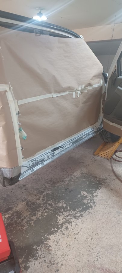

Patch panel for 3 door includes cab corner and rest of the rocker
rust removal
glued and screwed. Screw heads will be treated as welds and ground down.
bottom spot welded
didn't use the whole panel, cut off some of the top so body trim will cover
the center of the seam

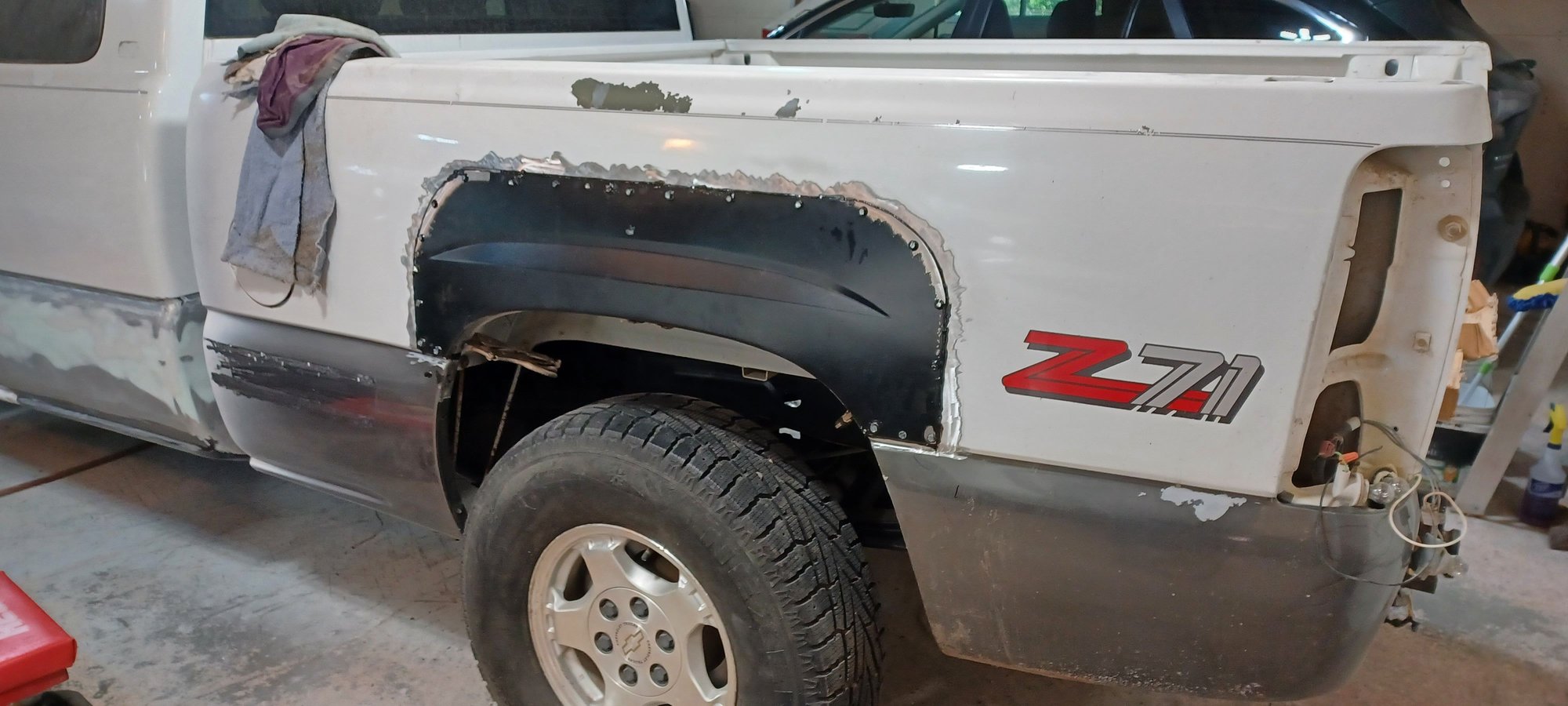

wheel arch patch panel. all panels get a 1 inch over lay
once cut hoping the wheelhouse was usable. no such luck.
passenger side worse than the other. new wheelshouse's ordered

Arch patch panels fit well. They are rectangle in shape so i rounded off the ends. makes for a better blend
metal cleaned up
filled and feathered. Brown filler was old body work somebody else did
Panels of course can be welded in...I suck at welding so adhesive was an easy choice.

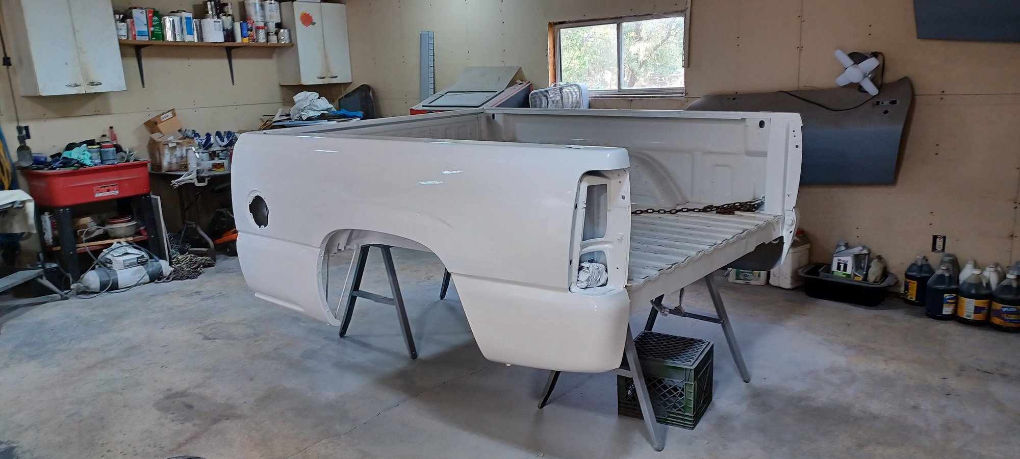

Box removed, ready for paint
2 coats epoxy primer...2 coats ppg olympic white...3 coats of clear
